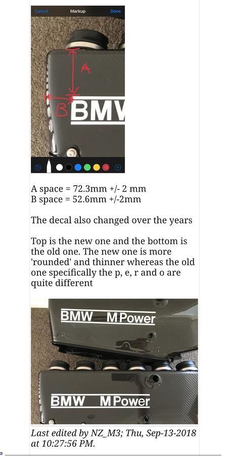

    My CSL airbox install isn't yet complete without the sticker! I should have put it on when the box was out of the car but that didn't happen.
    I seem to remember a thread that showed some specific measurements in regards to placement of this sticker but cannot seem to find it. Thanks.

        Obviously do another measurement by cylinder 4 saw a post a while back and they messed up bc they didn’t have a 3rd reference point.
        Budget CSL MAP Conversion
          I will definitely do that, off hand it looks like the large gap between "BMW" and "M Power" accounts for the strut brace so hopefully you see most of it at eye level.

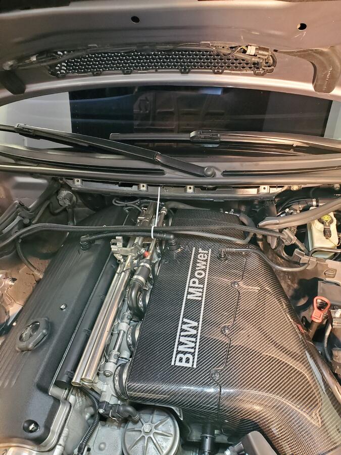

            Hell yeah.

              Looks good!

                    Out of curiosity, I'm guessing you've been running your car without the cabin air filter housing installed until your airbox install is finalized to avoid repeated removal/installation, and that's why your battery wire's ziptied to your CCV hose?
                    I'm fiddling with things a lot these days but I actually keep the cabin filter housing in place, just with none of the screws. I find it stays in place very securely when driving and doesn't cause any rattles/sounds, but you can literally just pull it out or put it back in a second by hand. That way you can keep your battery lines secured to it when driving instead of ziptying them to the CCV hose. Running the cabin filter housing sans screws is actually one of my favorite time-saver mods lol
                      I've been simply taking it on and off everytime (getting good at it, lol). I had it in place but worried it might screw me up mid sticker placement so I pulled it. That's also why the zip tie was there, just to keep everything that might screw up my sticker placement out of my way.
