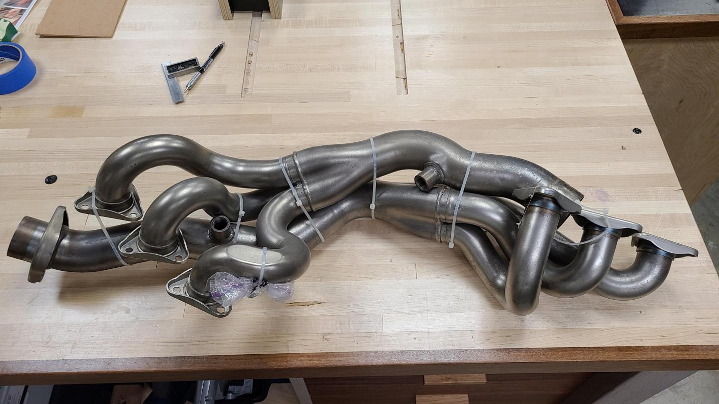

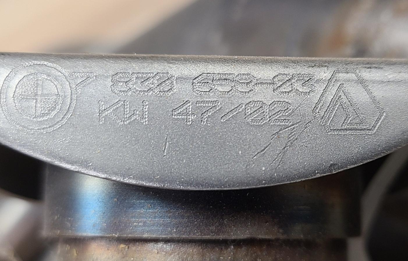

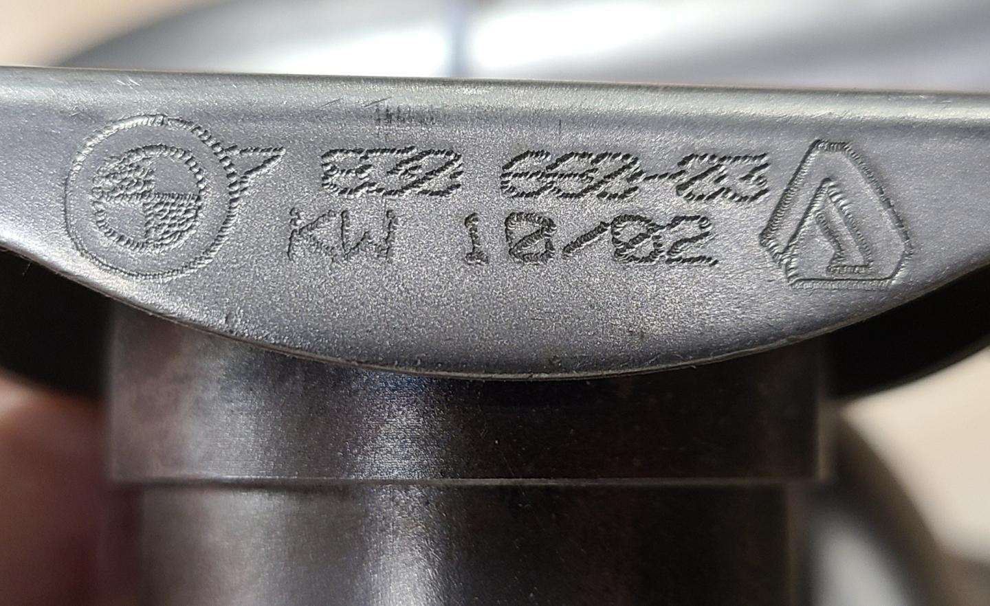

    I bought these headers years ago. Couldn't say for sure when, probably 2010-2012. They've been hiding up on top of a cabinet in my shop, honestly forgot about them until cleaning house. I posted about them in the zpost forum, got one reply with some part numbers that don't exactly match these.
    Anyone over here know what I have? I doubt they are CSL headers, I think I would have remembered that. I think they are the euro catless version, not even sure if they are specific to M3 or Z4M. Thanks for any help on IDing these.

    '07 M Coupe - RAC RG63 - AutoSolutions - Bilstein PSS10/B16 - Arqray
    Right hand drive standard BMW euro headers
