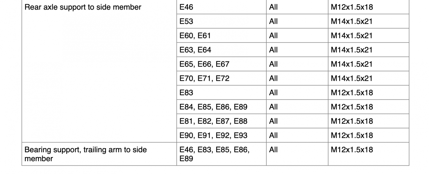

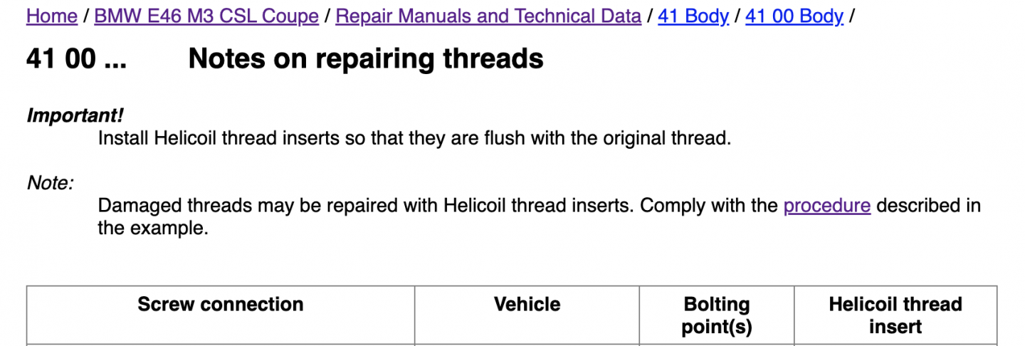

    TIS info -
    Thought that they would recommend a Timesert.

          If only the threads are stripped but surrounding not rotted, then I would try to install a Timesert. What do you see -- crossed threads or overtorqued and stripped?
            I'd choose a timesert over a helicoil as well. Those bolts see a lot of fastening/unfastening cycles.

                  Alrighty thank you guys. It sounds like the RTAB pocket reinforcement is optional/advisable for certain cars but not absolutely required. I think I'm going to go with the timesert option for now so I can have the car drivable. I would consider doing the reinforcement in the not too distant future as I have another repair that needs to happen in that general area.
