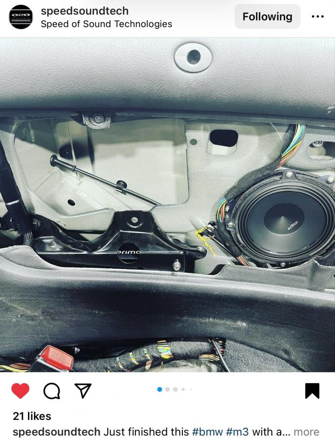

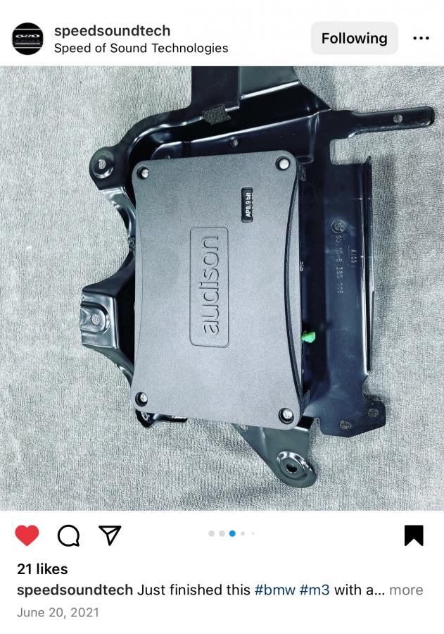

        Have an Audison Prima 8ch DSP amp in stock location (left rear pass. panel. Even fits in stock bracket
          Do you have independent SW control?
            Click image for larger version  Name:	IMG_9091.jpg Views:	17 Size:	110.4 KB ID:	256788 Click image for larger version  Name:	IMG_9092.jpg Views:	16 Size:	116.4 KB ID:	256789
            Very nice! What speakers are you running? Which headunit?
            Which car is that in? It doesn't look like how my coupe is set up.
                    Could you make a DIY on this or a thread with more info on this? This looks great, curious how you did it all!

                      My full set up:
                      Sony XAV AX6000
                      Audison Prima components + (1) 10" sub
                      Audison Prima 8.9 8ch amp+dsp
                      Rockford Fosgate 300w mono amp for sub (Audison was out of stock at time)
                      Full active setup, sub has separate RF control knob
                      car is an '04 convertible
                      All work was done by Speed of Sound in Milford CT
                        That's more or less THE setup if you don't need the head unit to look factory. And these guys are the real stars here. You want professional installers who live the work, whatever you do. I just did what my guys suggested given my choices, and the sound deadening on the convertible doors and floors was the best money spent.
