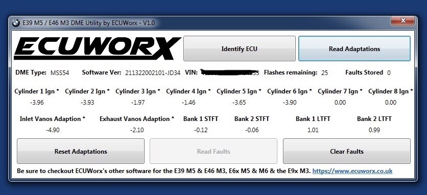

                I've been doing a lot of maintenance on my new S54, but it's still around -4 across all 6 cyl. I replaced both CPS and the vanos adaptations got cut down in half (-2/-4 to -1/-2) which was nice. But ignition stayed at about -4 across all 6 cyl.
                So the car is sensing too much fuel, not enough air, and is pulling back? But the air filter and MAF are new and the intake tract is clean/smooth, airbox is clean inside. Every sensor and filter has been replaced except for crank and knocks. Vanos solenoid from besian, but that could still be an issue maybe.
                Checked for vacuum leaks, though vacuum issues would cause lean condition I think. Ignition is pulled across all 6 cyl so not a bad plug, coil or injector. No issues with fueling as far as start up/idle. Idle is rock steady.
                Very confusing. Car runs strong, no codes, but I want perfect.
                I do have catless headers (cats now in sect 1), but I'm not sure how relocating cats would cause changes to AFR. I didn't think you *needed* a tune after fitting catless headers (though it is recommended ofc)
                I'm thinking I need to do a vanos test.
                  I replaced both CPS and the vanos adaptations got cut down in half (-2/-4 to -1/-2) which was nice..
                  Sorry to pop the bubble but replacing CPS's is like using a different yardstick to measure Usain Bolt's speed -- longer stick says he ran 8 yd/sec and shorter stick measured 10 yd/sec. As the vanos timing wasn't adjusted then nothing really changed.

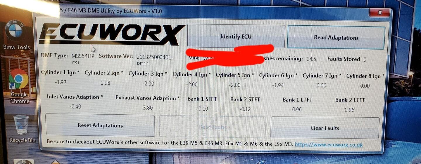

                          In my opinion that’s not looking very good, if your tune is based on CSL PD31. If I remember correct, the max knock adaption is limited there to 2.00°cr. So it can‘t go any higher than 2.00°. So if all knock adaptions are maxed out to max, you have to much ignition advance in your tune for you engine or wrong fuel.
                          I got similar results with wrong fuel in tank, I mapped my CSL based tune to 102 octan (German premium fuel) and when I put 98 in my tank I also have 2.00° across all cylinders.
                          …under construction.
                            Well, that was base tune, I've since had it dyno tuned and after 1 hour drive the adaptations were the same. I'll have to re-check adaptations again seeing as it had been driven more since the dyno tune and maybe ask the tuner. I am only using premium 91 octane fuel in the vehicle.
                              Try to reset the adaptions with ecuworx tool or Inpa before next drive and do a long drive with mixed profile (part&full throttle) and read again.
