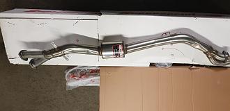

                  Found this pic online. The Dinan piece doesn't seem to neck-down to fit the factory section 2 anywhere I can see. That being said, when I bought the car it had the factory section 2, so IDK how that worked.
                  2004 Dinan S3-R M3
                  2023 X3M Competition
                    It's not the Sect 3 that steps down, it's the end of sect 2, the inside pipe slips into sect 3 and the other side butts up to sect 3 bell flange, with a donut ring used to seal.
                    There are sect 3s that step down, but that's becuase they are 60mm. Dinan is 63.55, so it doesn't step down.
                    The dinan pictured above looks exactly like the 63.5mm scorza or scza look. No issue at all, normal.

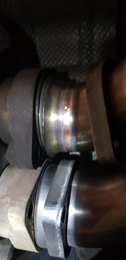

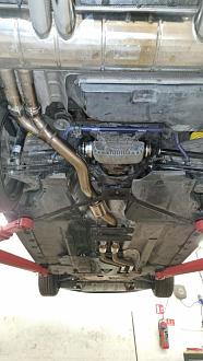

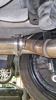

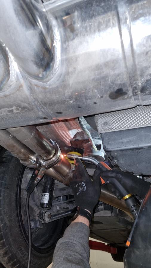

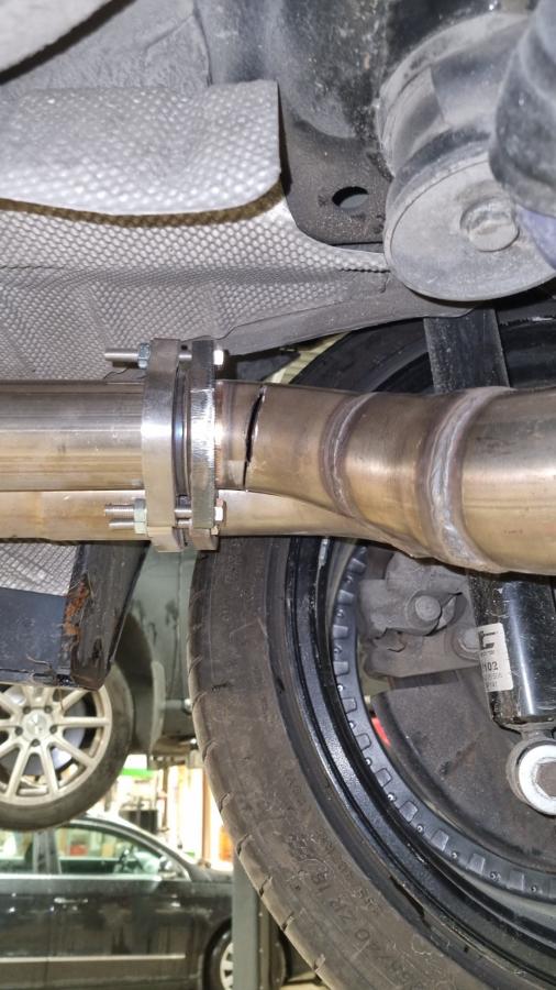

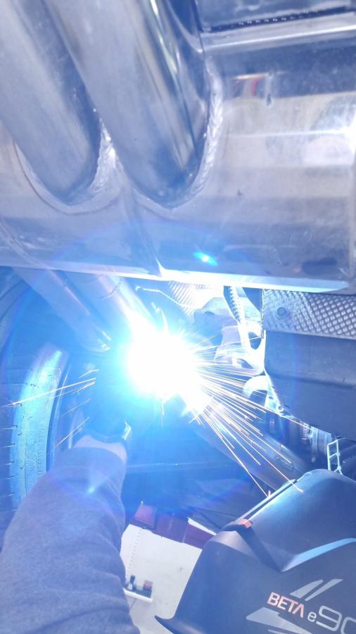

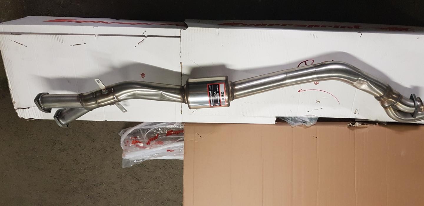

                          FWIW I had a supersprint section 2, though a resonated x-pipe fitted to my car a couple of years ago, and one pipe was off, but not by so much it wasn't possible to force it onto section 3.Click image for larger version

                          OEM section 3:

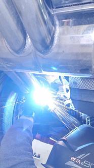

                          I had a local shop cut a slit in the offending pipe to realign and reweld. Not sure why this was as IMO Supersprint should be a renowned manufacturer. Eisenmann Section 3 here:
ID:	258526 Click image for larger version
ID:	258527 Click image for larger version
ID:	258528 Click image for larger version
ID:	258529 Click image for larger version
