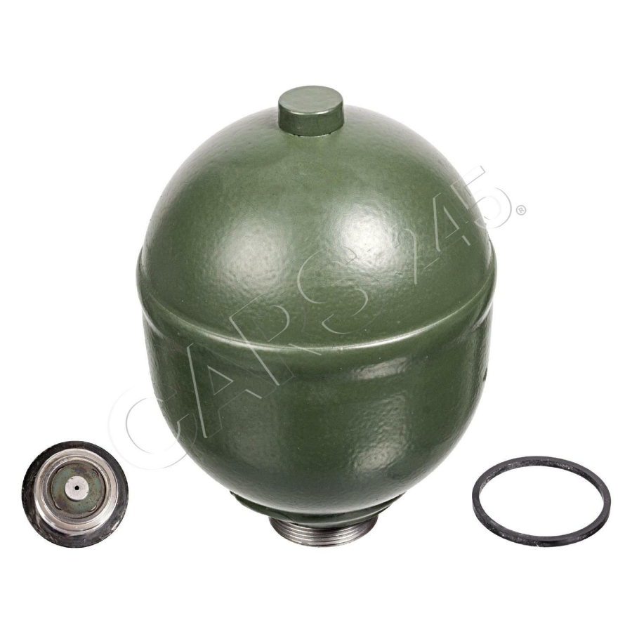

            Then this is a challenging design to have the moving piston (which separates the gas and oil) in a cylinder that provides almost no gas leak performance for many years consider it moved many cycles per trip. The vintage Citroen DS and SM used a rubber diaphragm to separate the oil and gas in their ACC, and every 3 to 5 years we have to charge up the Nitrogen gas as it leaked through diaphragm.
