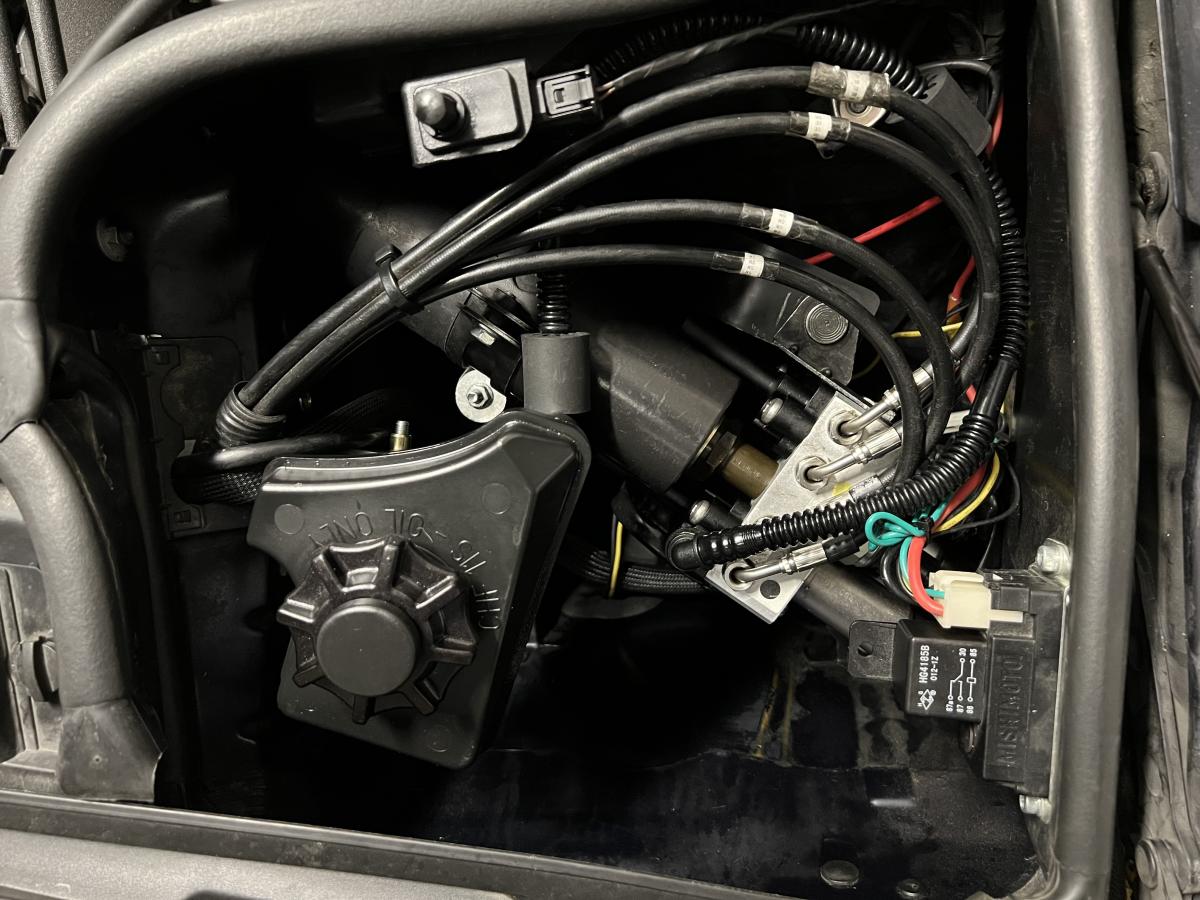

      +1, just installed the MLR rebuilt pump with upgraded reservoir and accumulator. It is pretty huge so had to modify the custom bracket a bit.
      Just went to Laguna without issues -- doing 3 more track days in the upcoming month so let's see if continues to hold up.

        Love to hear these SMG success stories!

          Excellent!
