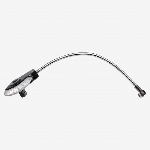

    Stahlwille 7380N Torque Angle Gauge, 1/2" Internal drive, 1/2" External drive - high quality German engineering at the lowest price
    With that said nowadays I do use a 3/8" techangle for some and actually still do use that stahlwille for others. It really boils down to how strong you are and how much room you have to work with. If you can't get a full 105* swing then sometimes that longer bar is helpful to reset and do the last 20* (or whatever it is). The other side is the longer bar means you need more room so if you can swing the 3/8" bar you have a better chance of getting the full angle in one go.

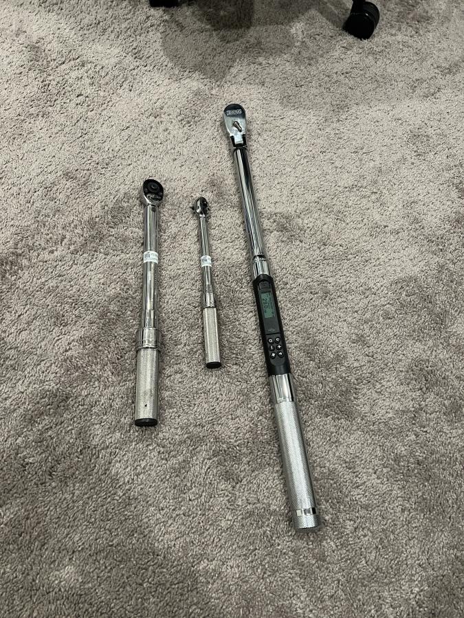

                        Just to update as i'm in the middle of the bearing job now. I ended up going with the Icon 1/2" digital torque wrench with angle.
                        Here's the arsenal I'm using:
                        My thoughts:
                        Pulling angle in one sweep is still hard as f even with the 1/2". It took me a couple of tries ​to nail it(M11 bolts), then I opted to have a helper hold the ratchet head down so I could use my second hand for leverage.
