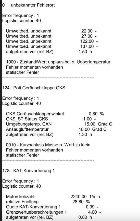

    CEL came on with some codes a few hundred miles since I have installed my Carbon airbox with a map conversion. I am not sure they are related, but, here is what INPA is reading.
    The only code remaining is 124, it's persisting through resets, cannot find any information about it online
    Attaching the errors as a PDF, error code reads:
    124 Poti Geräuschklappe GKS
    Error frequency : 1
    Logistic counter: 40
    GKS Geräuschklappenwinkel 0.80 %
    GKS_ST Status GKS 1.00 -
    Umgebungstemp. CAN 15.00 Grad C
    Ansauglufttemperatur 18.00 Grad C
    aufgetreten vor (rel. BZ) 1.30 h
    0010 - Kurzschluss Masse o. Wert zu klein
    Fehler momentan vorhanden
    statischer Fehler​
    Car is running a CSL tune sans a few options with the airbox.

    That's the code for the CSL intake flap. Safe to ignore if no flap installed. You can also suppress the code if you don't want it to keep popping up: https://github.com/saildot4k/MSS54-X...ion-Strategies
