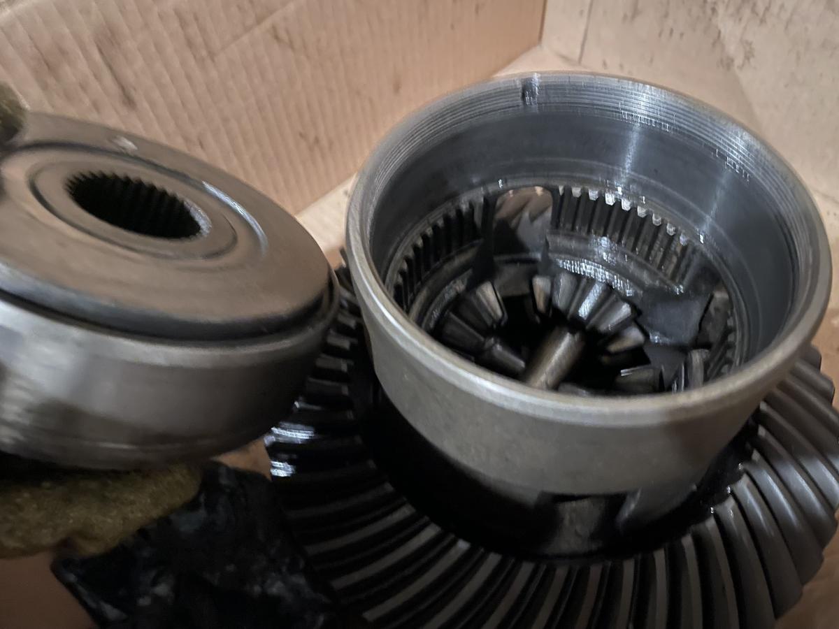

                    I was partially successful. Was able to open the carrier but could not remove the ring gear. The tool I got is not powerful enough, so do not buy lol
                    To be able to open the carrier, I used zip ties to make sure the tool was fully seated on the carrier cap, this was enough to be able to tap it with a hammer.
                    Click image for larger version  Name:	IMG_1705.jpg Views:	4 Size:	90.2 KB ID:	297547
                    Then tap it away!!
                    Click image for larger version  Name:	IMG_1706.jpg Views:	4 Size:	100.4 KB ID:	297548
                    After a few hits, it was obvious that the cap started to spin. See the hole I had tapped before, it confirms displacement
                    Click image for larger version  Name:	IMG_1707.jpg Views:	4 Size:	108.5 KB ID:	297543
                    A few more taps until you can remove it by hand...
                    Click image for larger version  Name:	IMG_1708.jpg Views:	4 Size:	94.0 KB ID:	297541
                    Now, since I was not able to undo the ring gear, I had to pry on the bearings, dont do this if you are not replacing them, in my case, I am, so it did not matter. It did not take much force, just push gently until you feel it start to move.
                    Click image for larger version  Name:	IMG_1709.jpg Views:	4 Size:	97.7 KB ID:	297549
                    Now the viscolok pump comes out.
                    Click image for larger version  Name:	IMG_1710.jpg Views:	4 Size:	100.0 KB ID:	297542
                    Now you have access to the inner guts, there are the clutches
                    Click image for larger version  Name:	IMG_1711.jpg Views:	4 Size:	128.2 KB ID:	297550
                    I took the spacer gear, which is the one that spin the clutches, the steel plates gear up to the outer inner teeth in the carrier. The thickess of this gear is what you can use to define the max clutch+steels stack before having preload, per design, there does not seem to be preload.
                    Click image for larger version  Name:	IMG_1712.jpg Views:	4 Size:	103.3 KB ID:	297546
                    As you can see below, the clutch pack is no thicker than that spacer gear
                    Click image for larger version  Name:	IMG_1713.jpg Views:	4 Size:	80.5 KB ID:	297545
                    Also, the viscolok pump bottoms out on that ledge above teeth to which the steels mesh up
                    Click image for larger version  Name:	IMG_1715.jpg Views:	4 Size:	90.0 KB ID:	297552
                    So, the assumption that you can adjust preload by tightening the pump locking ring is partially incorrect, as the pump seats on that edge within the carrier, and that is the limit. what would allow some "pre load" adjustment is if you have a clutch stack a bit thicker than the spacer gear, but only if it is compressible, like the pre load shims RD provide. I don't plan to use those, but rather just replace the friction (clutch) plates.
                    Many say the GKN unit is a bad unit, I don't think so, is actually a nice engineering bit of kit as it allows for no lock, to "100%" lock.
                    I need to clean all up so I can measure the thickness of the steels and clutches to compare VS RD kit.

                      I guess it is to a point. We got more pre-load when we tightened the ring. We got the entire kit, so there is an additional shim needed?
                      Either way, the GKN unit is fine for the street. Any high performance use without traction control on, the GKN unit is too slow. It needs wheel slip before it starts to lock so the car is starting to rotate, the driver unwinds the wheel and then the back end will still rotate then the diff locks and then the rear oscillates the other direction - tank slapper. A good driver is conservatively going to be about 1-2 seconds faster on a 1:50 lap with a ZF.

                            Is the locking ring bottomed on this step? If it is then one cannot tighten the ring for preloading the clutch.
                            "the clutch pack is no thicker than that spacer gear"
                            Pic above seems to show the spacer gear is below the top clutch stack shim. No?
                            "Now, since I was not able to undo the ring gear, I had to pry on the bearings, dont do this if you are not replacing them, in my case, I am, so it did not matter. It did not take much force, just push gently until you feel it start to move."
                            I think one could pry the clutch stack up via the carrier side holes instead on the bearing.
                            "The thickess of this gear is what you can use to define the max clutch+steels stack before having preload, per design, there does not seem to be preload."
                            If no preload then one can spin one wheel with the other on the ground but this is not the case, and this means clutches are preloaded, and without using a spring washer. Keep in mind the pump movable piston is thicker than the center static part which is pressed on the 'spacer gear' to define the spider gears backlash.
                                Click image for larger version  Name:	image.png Views:	0 Size:	416.5 KB ID:	297619
                                No, it sits slightly higher than the end of the threads. there is a spring washer between the locking ring and the top of the pump, as you tighten the collar it compresses it a bit, so the pump is fully seated in the carrier case.
