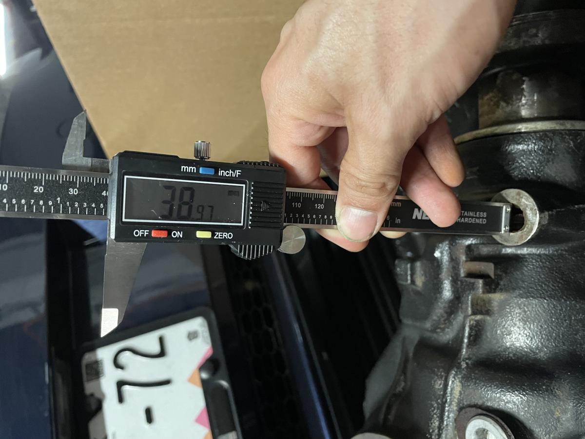

                        I also measured the depth of the front bolt and is very deep, 39mm
                        I need to measure the bushing width and see what length of time-ser works best as is key to make sure the bolt ends passed the insert inside the cavity.
                        now, I measure the hole and is 12.7mm, by the look of it is like the threads are stripped, but I wonder if it is only corrosion and I should try a thread chaser first
