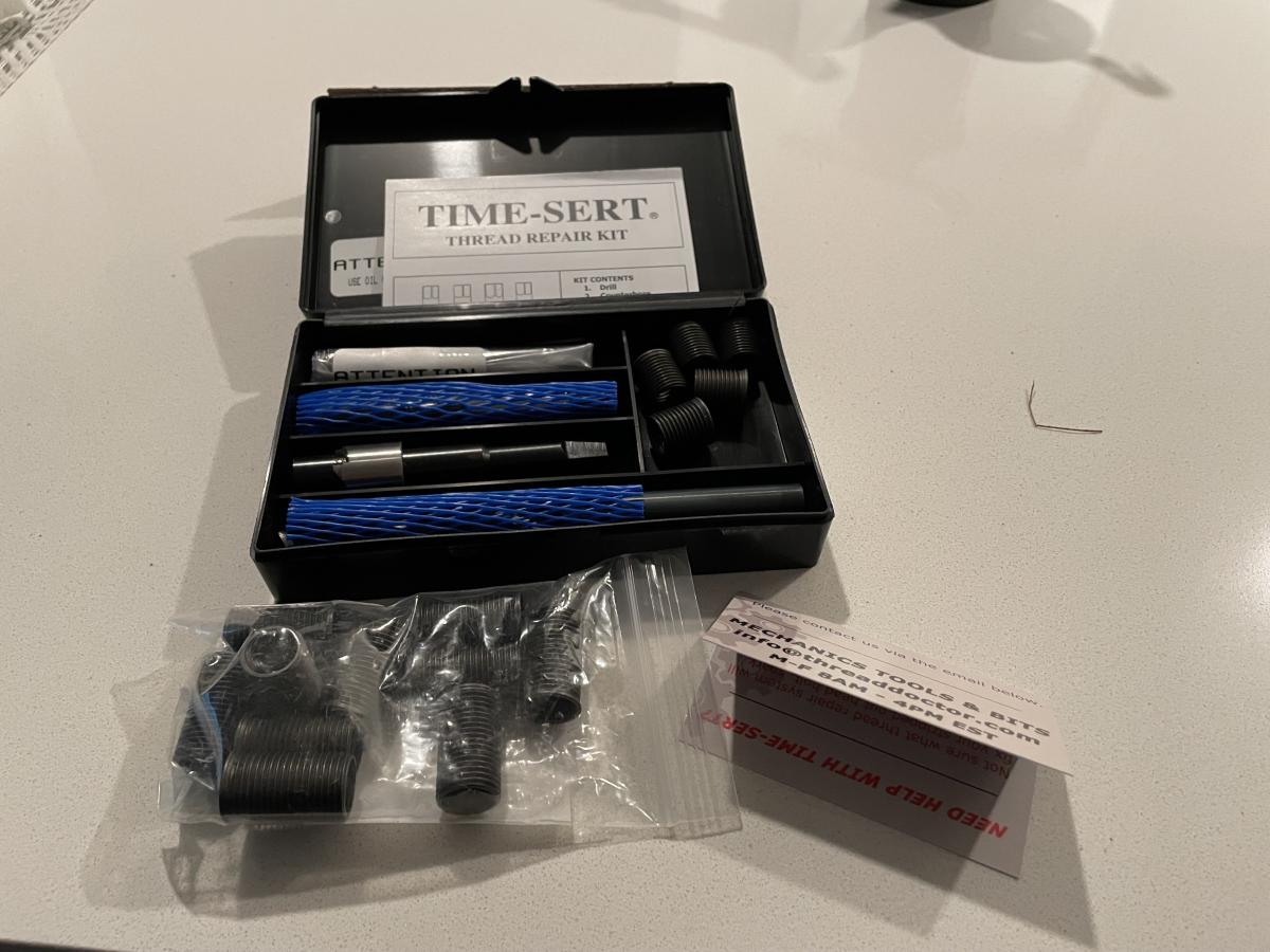

    2. The installation tool is nothing but an M14 threaded shaft, to which the insert screws like a glove, it does not have the correct shape to form and expand the insert in place.]
    The installation tool is a simple M14 with a stop, nothing special. I believe you have a fake Timesert; real one has the bottom compressed slightly so when the installation tool threaded through it expended and lock to the diff.
            the install tool IS NOT just an M14, very different.
            see how different the tools is, is not round and has cutting threads to form the insert and lock it in place. Also, you CANNOT thread the insert into the tool much.
            quality of the kit is high, definitely a quality tool.
