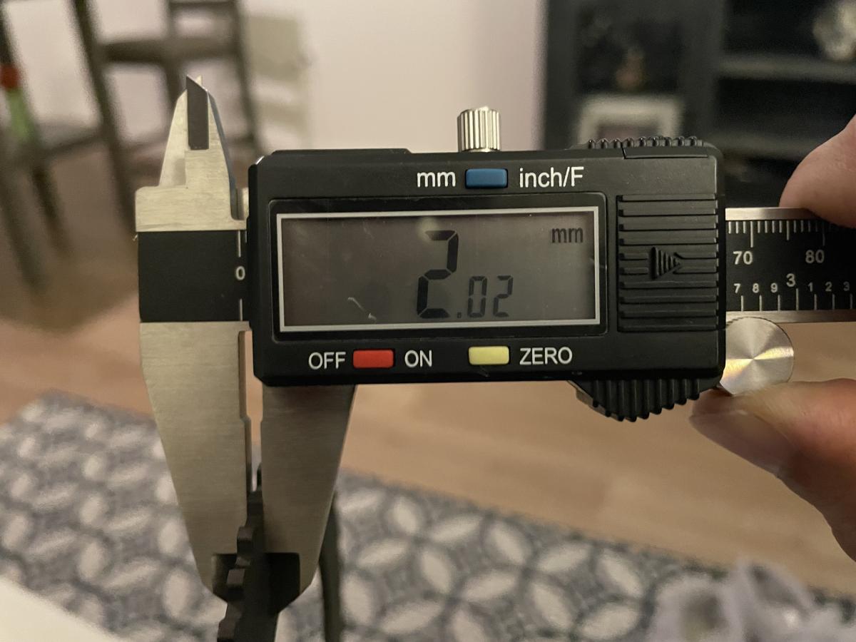

                          Thick steel plate: 2.02mm (1)
                          Click image for larger version  Name:	IMG_0518.jpg Views:	0 Size:	90.0 KB ID:	263502

                          Total stack based on Individual component values - 12.67mm
                          The big spring washer that goes on top of the stack and between the lsd pump is 4.6, and can compress flat to 2mm
                          so total value is ~17.27mm (uncompressed) or 14.67mm (compressed)
                          I also calculated the load the washer needs to compress flat and is 3300N or 320kg (~700#) of force which is meaningful, however without knowing the pump capacity I don’t know if this is much or not; hydraulic pumps have high force capabilities, so if we make an analogy to a car jack, you get the idea.
                          the “free shim” washer needs 2000N to go flat, so I don’t like that much preload for the spider gears. So I will go with flat shims and leave some slack (0.1mm).
