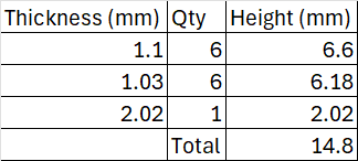

        I am trying to source 1 more clutch and 2 more steels. if I can do that, this will be my array
        Thickness (mm) Qty Height (mm)
        1.1 6 6.6
        1.03 6 6.18
        2.02 1 2.02
        Total 14.8
        If not, I plan to reuse 1 clutch, and 2 steels from the OE setup. This will leave me at 15.2mm.
        We'll see.​

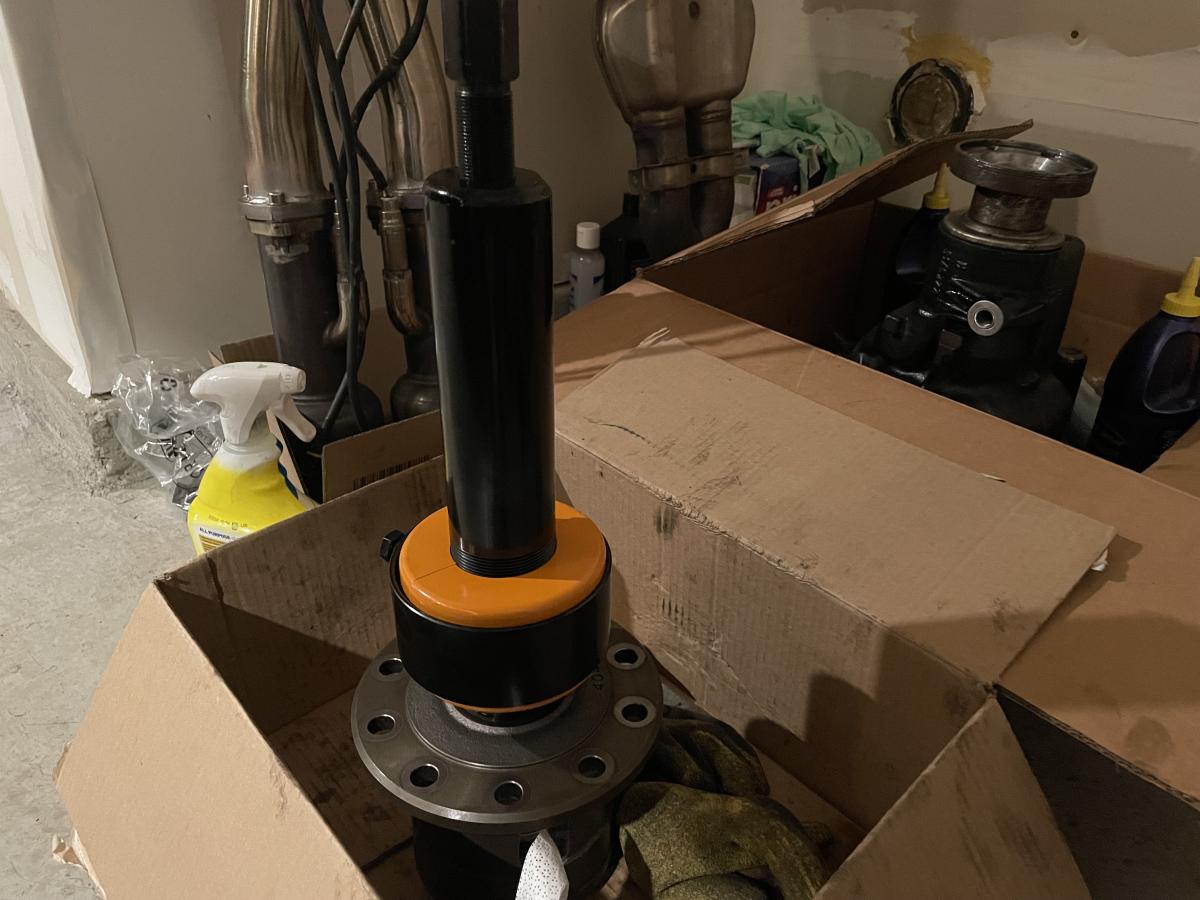

                              moving on, I removed the old bearings, for this I got a bearing puller and it worked great, it really removes the bearings in a breeze.
                              Click image for larger version  Name:	IMG_1833.jpg Views:	0 Size:	106.1 KB ID:	300757
                              I did not take a photo of the pump side bearing but you must remove that with the pump off the carrier as the tool does not fit otherwise.

                                To close the carrier I use the same method I used to open it, get to as close as I could, the. Zip tie it and use a hammer to tap the tool and lock it in place.
                                Click image for larger version  Name:	IMG_1837.jpg Views:	0 Size:	137.7 KB ID:	300761
                                the final torque was a bit lower than what I expected, but it is very similar to how it was before, this makes me think the unit was still ok, also the clutches looked fine!
