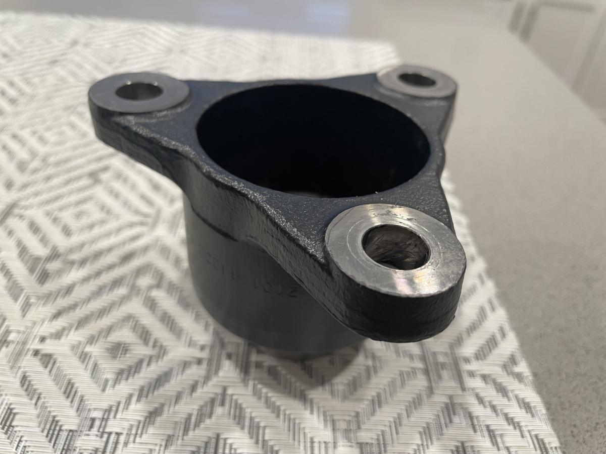

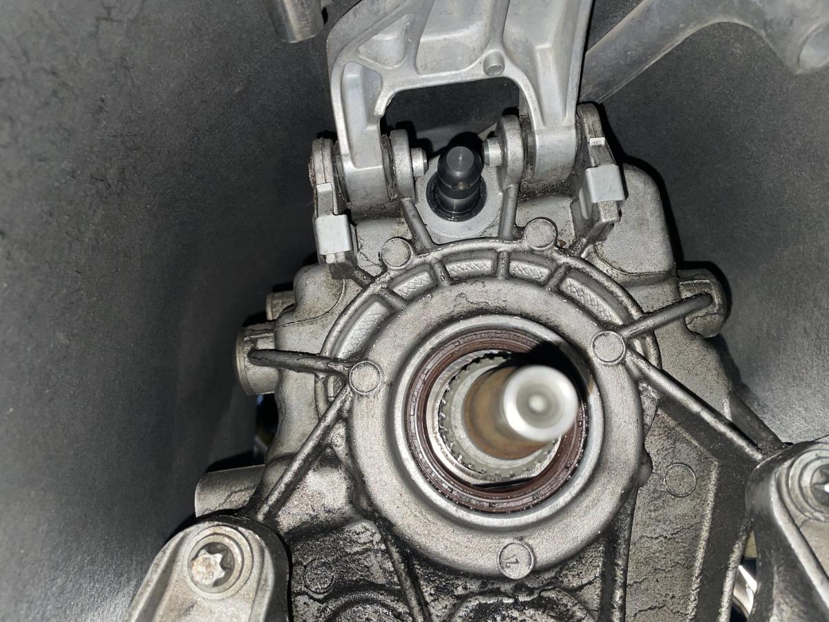

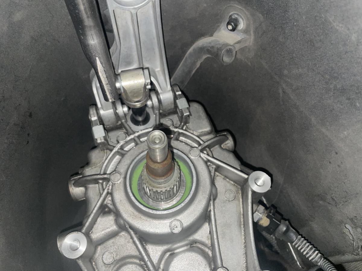

          I found that my transmission output seal was leaking, so I have to remove the flange, and while at it I chose to also change the shifter rod seal

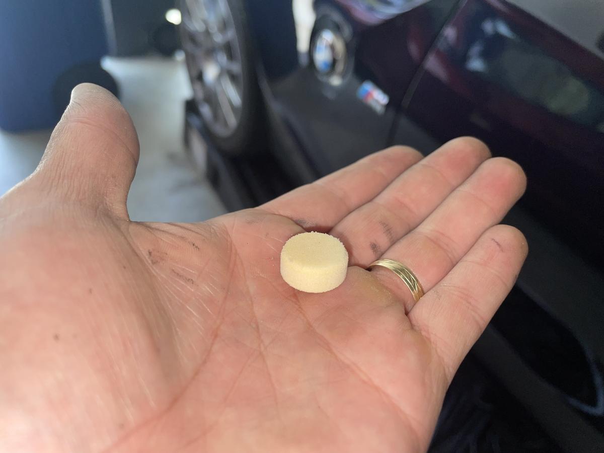

          I also noticed the PO when changing the shifter ( I have the ASS kit) did not put the yellow foam inside the clevis so I got a new one, this may to dampen some vibrations I have when revving above 6k

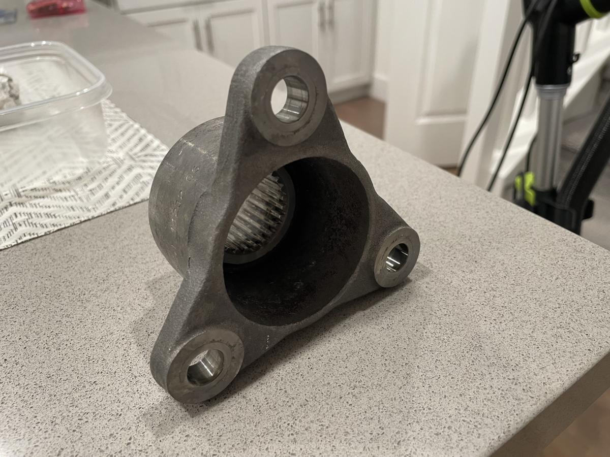

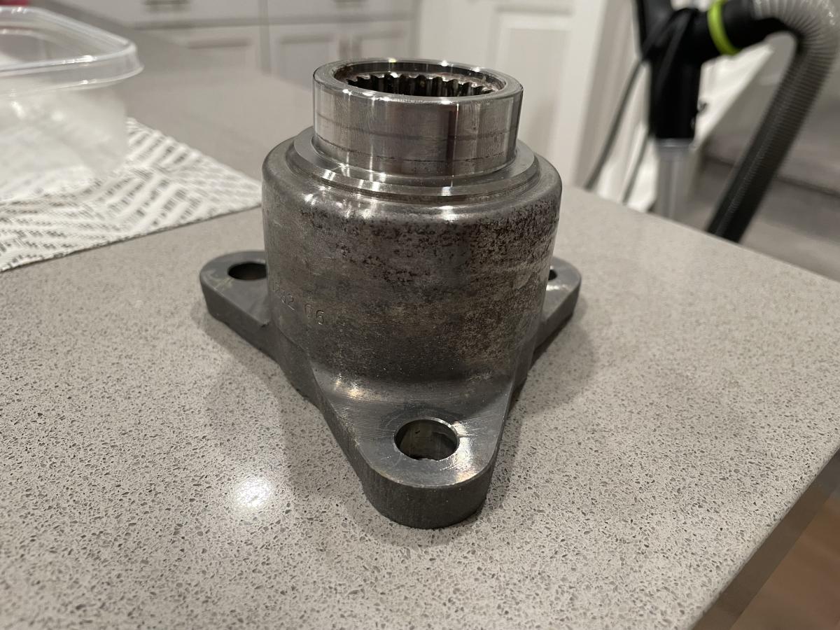

          the flange was a bit grimy and had some superficial rust. So I dipped it in evaporust and then used permatex rust protection, or black oxide solution
          before
          Click image for larger version  Name:	IMG_1993.jpg Views:	0 Size:	168.0 KB ID:	304606
          after evaporust dip
          Click image for larger version  Name:	IMG_1994.jpg Views:	0 Size:	165.7 KB ID:	304607
          after black oxide
          Click image for larger version  Name:	IMG_1995.jpg Views:	0 Size:	99.9 KB ID:	304604
          i know this is not bullet proof, but is in a mostly dry area so it will be for sure best than raw metal

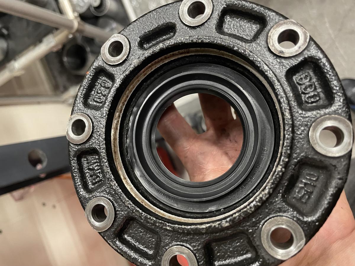

            Continuing on… I had issues with racing diffs seal, the vulcanized rubber part bunches up while pressing it. I ended up buying Corteco.
            Click image for larger version  Name:	IMG_1998.jpg Views:	0 Size:	185.3 KB ID:	304685 you can see around the edge of the seal the small sections where the vulcanized rubber catches up with the metal edge of the cap, it could be it would be fine but last thing I want is a leak.
            the corteco seal went in perfect.

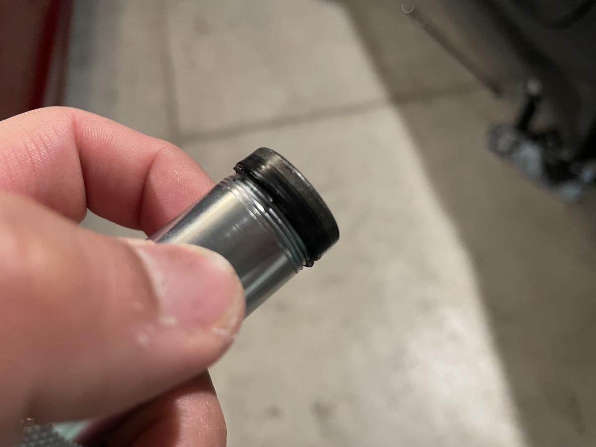

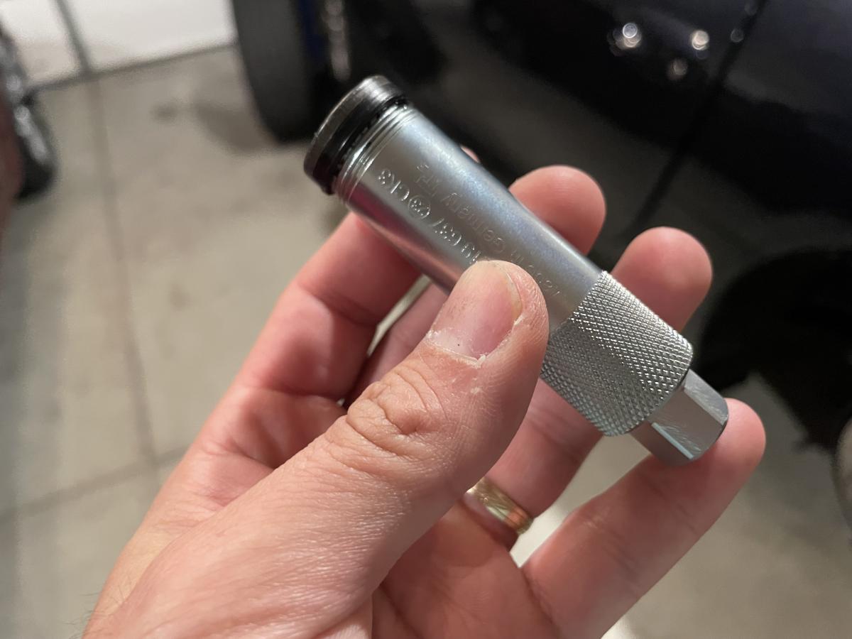

              Coming back to the shifter rod seal. Here some photos of the tool with the old seal on it. The tool thread into the seal and once it has threaded in 3 or so turns you use the screw provided with the tool and tighten it to pull it out. Then the old seal becomes an adapter and you can use the same tool to drive the new seal in

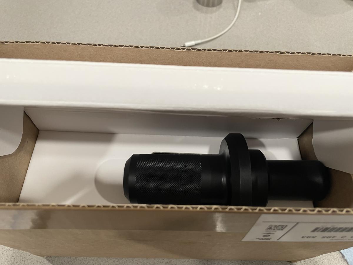

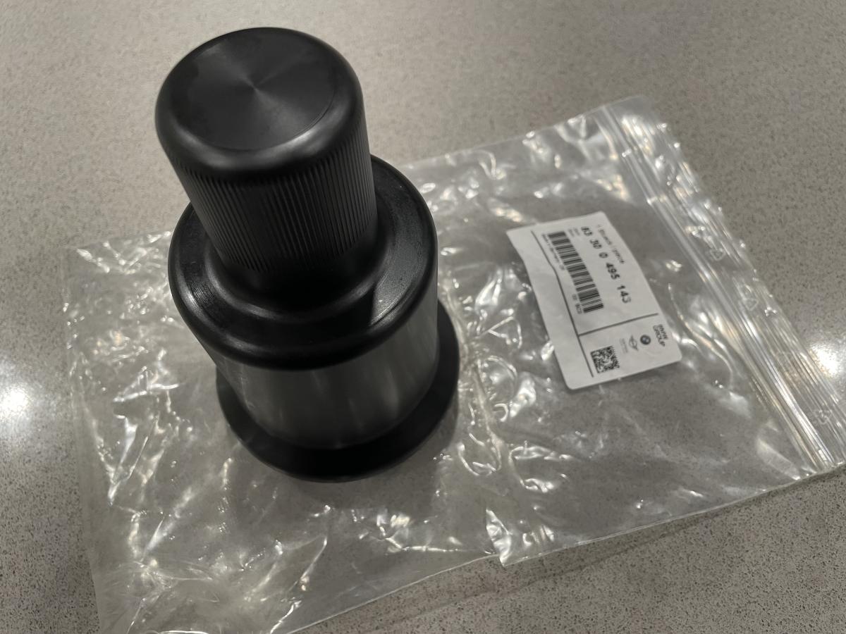

                As I mentioned above, the diff seal tools are super nice, cut out of aluminum and thus super light and well made, but the output shaft seal tools does not set the depth as it can go through the cap completely, so the reason Inbought it was to set the depth, otherwise I could just use other bearing drivers I have access to. So will return it.
                the pinion seal tool can be skipped also as the seal bottoms out, or set it at 3mm in from the outer surface of the diff.

                  Dang. I never used the racing diffs seals out of paranoia. I guess that was a good call...one of m few. lol

                      What drove me to buy the tool was the removal, if you have the tranny off the car you can be more careful and find a way to pry the seal without damaging the housing, and the tool was perfect for that.
                      now, I had read that a 15mm socket can drive the seal in, but in my case the 15mm was just not big enough to slide over the shifter rod, and since I had the BMW tool with the old seal on next to me I was like! Oh! Perfect!
                      But you can very like make it work with other tools, but this was a 3 min job to remove and maybe another to tap it in.

                            Made some more progress, I took the diff off the car, not much I can add that has not been shared online. If anything, just make sure the car is as high as possible.

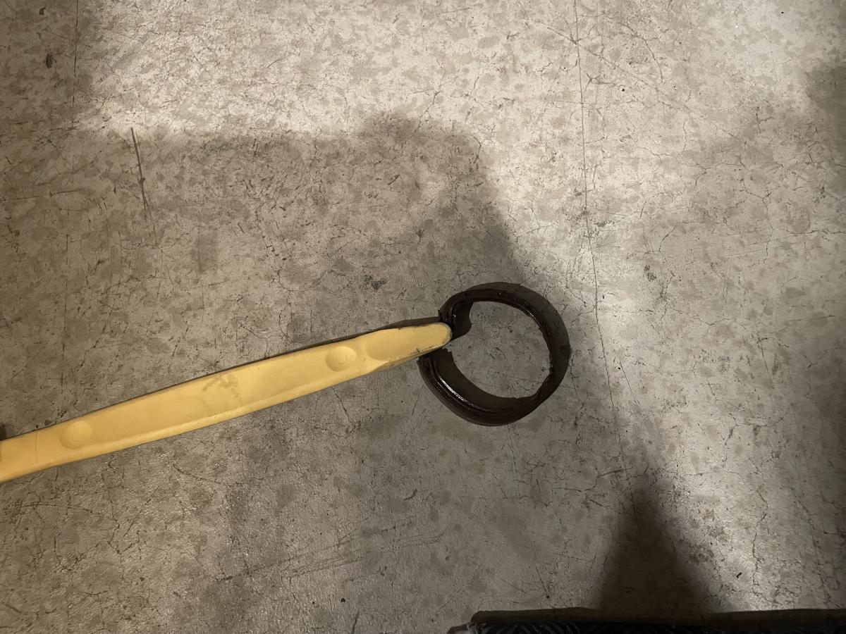

                            I also removed the old transmission output flange seal, I used a trim tool to punch the seal and then pry it out without damaging the transmission case, which is very soft. I was getting frustrated as any metal tool will nick the aluminum and you don’t want a scratch on the sealing surface.
