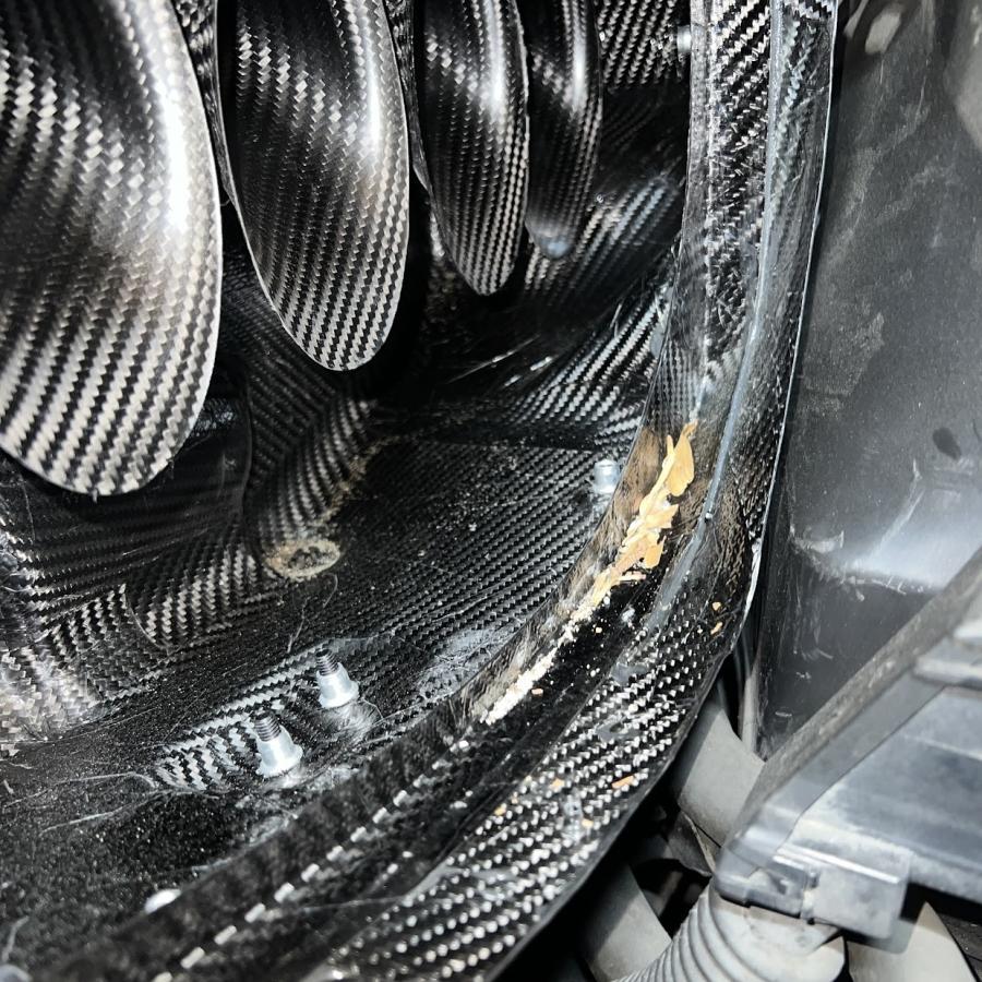

    When taking the OE CSL air filter off, I noticed extra road debris jammed under the filter in the back corner. Most of the big debris I scooped out before taking the filter off, but these smaller debris were sitting under the filter between the box an filter, indicating a gap in this area

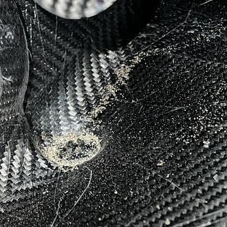

    Then I noticed more fine particles like silicon/silicium (road sand/glass) finely coating the box towards the back, mostly around the crankcase breather hose and even coated behind the filter only in the same area
    Click image for larger version  Name:	IMG_6898.jpg Views:	0 Size:	191.4 KB ID:	260729
    This is unsettling to know that there is a little gap in the filter foam surround and its resting nook in the back corner as it has been allowing fine particles to enter into the plenum, into the chamber for combustion, and down the oil line.

    Before mentioning user install error, I always have inserted the air filter into the rear corner first, then pressed from rear to front.
    The filter even had such a tight fit that I had to use a pick to be able to pop a corner out when removing the filter, so there was no movement possibility.
    This was a brand new install with the box, air filter, and all fittings bought from Haimus and been using for 4500 miles now
    The question now is...was the Genuine CSL air filter a faulty one I received, or was it just my luck with the carbon box build being slightly off measurements
    Has anyone else experienced or seen this yet?
    My plan of action was to simply clean up the filter, and adhere
    another stronger foam gasket around the perimeter for an even tighter seal

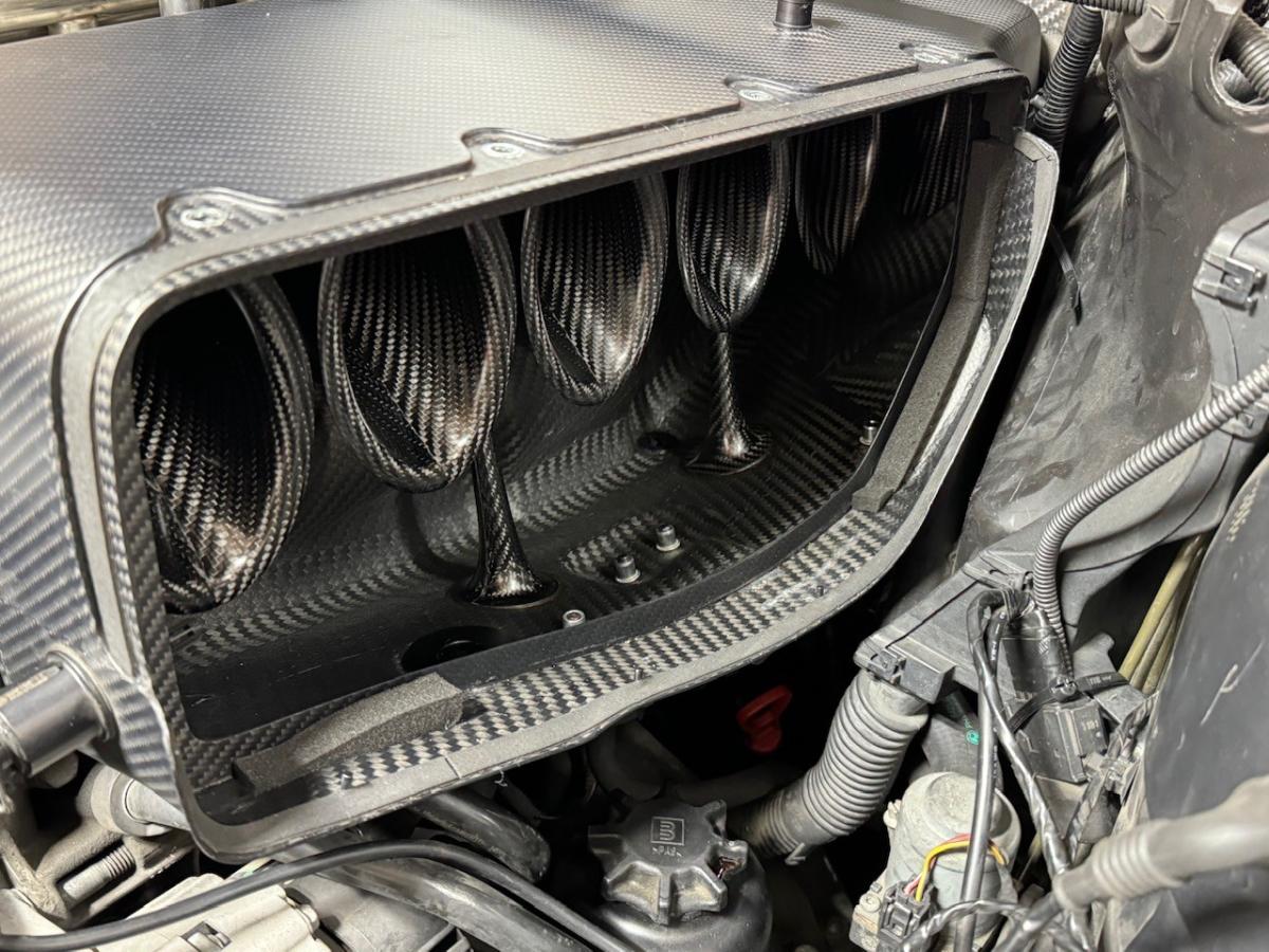

                Same issue here with my 2022 Karb box. I added foam in these spots:

                      This happens even on the stock airbox to a certain extent. The last higher mileage stock airbox I looked at had a medium film of oil and dust in it. The CSL filter material is not as dense as the stock filter, so it can let some small particles through. Not really an issue. If you start seeing pebbles, then you should check the filter or sealing area.
                      As mau said above, it is a good idea to vacuum the perimeter of the filter every so often as debris will gather there. When the airbox comes out, then you can do a full cleaning. NZ_M3 said he uses Simple Green and hoses down the airbox lol
