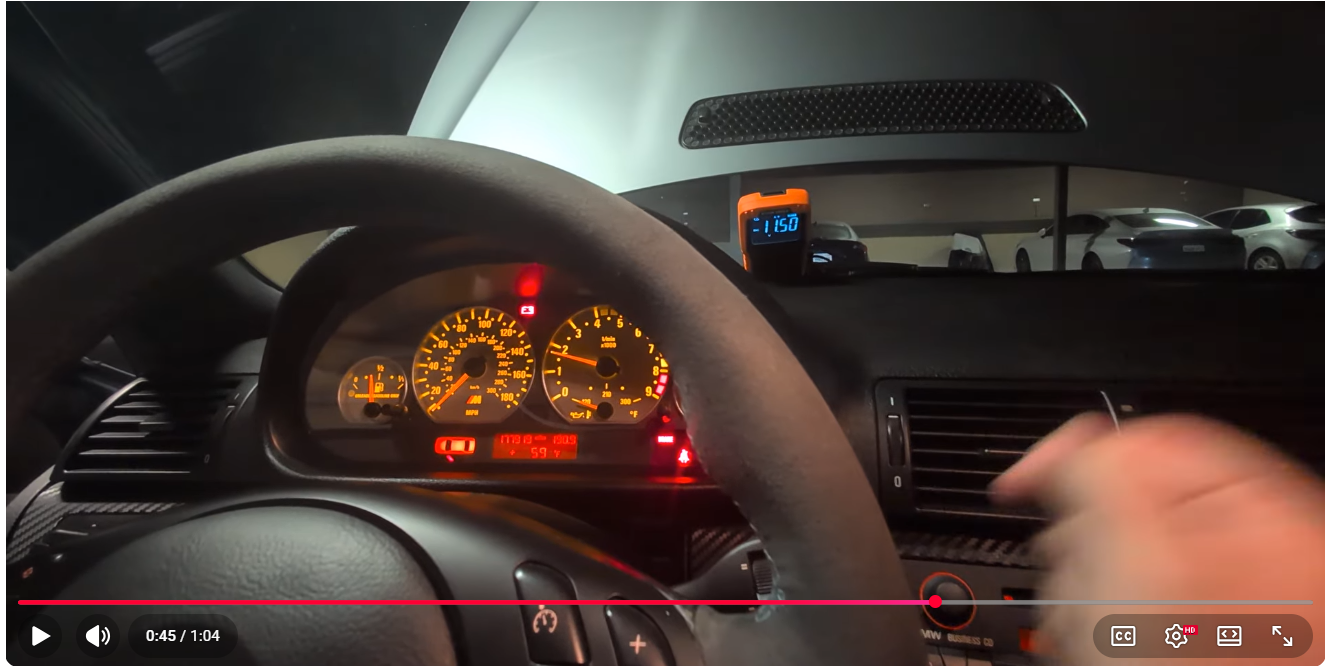

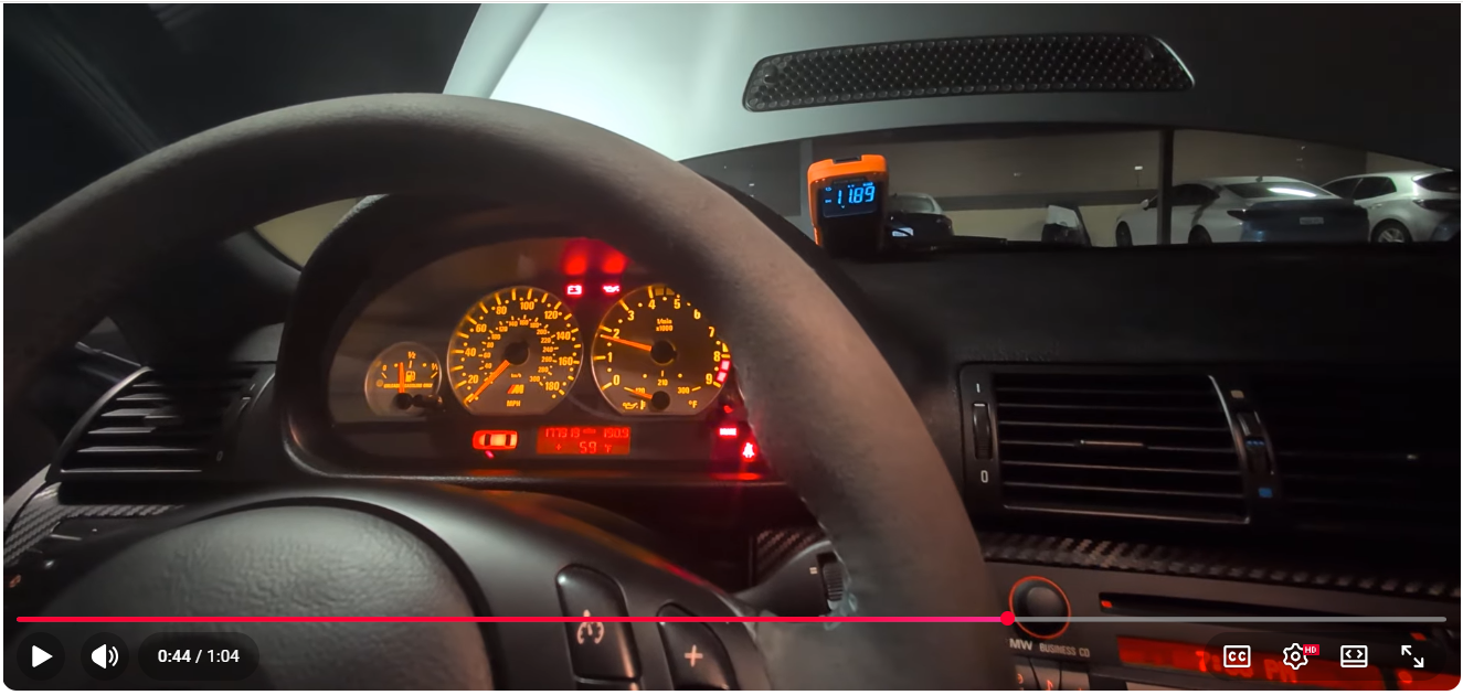

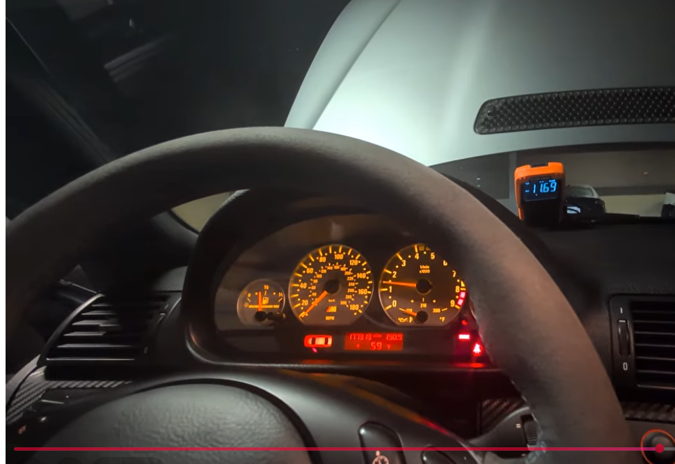

                Interesting that the red batt turned off when the voltmeter still shown only 11.69v in the video. Where was the meter connected? I also wonder if the DMV reflesh/sampling rate is too slow to cause the delay on the 11.69 value.
                12.43v is not too low in cold weather, so the batt is ok.
                Click image for larger version  Name:	image.png Views:	0 Size:	549.4 KB ID:	340616​
                  I connected the multimeter to front jump posts in the engine bay.
                    I wonder why the voltage dropped from 11.89v at 0:44 to 11.50v at 0:45 in the video. With engine RPM close to 2000, what load that sucked the voltage from 11.89 to 11.5v in 1sec?
