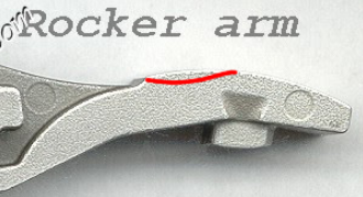

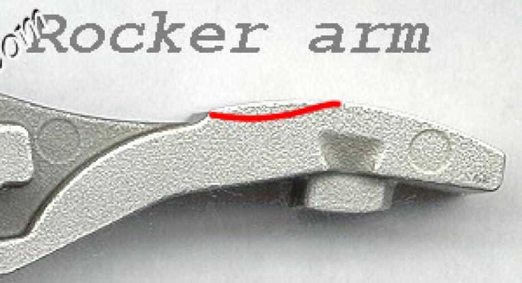

            My tick was a very very worn rocker on cyl.5, exhaust side, a lof of material was missing for it to tick that bad.
            Before you put in the new cams and rockers, did you carefully inspect all rockers? I could pick out the bad one every time, even with my eyes closed, purely by just feeling the curve with my finger, it's quite obvious, but to the naked eye it might not be as obvious.
            Although a bit exaggerated, the red line below is what my rocker arm looked, or rather felt like, it's difficult to spot while still in the engine, but easily spotted when held on its side.

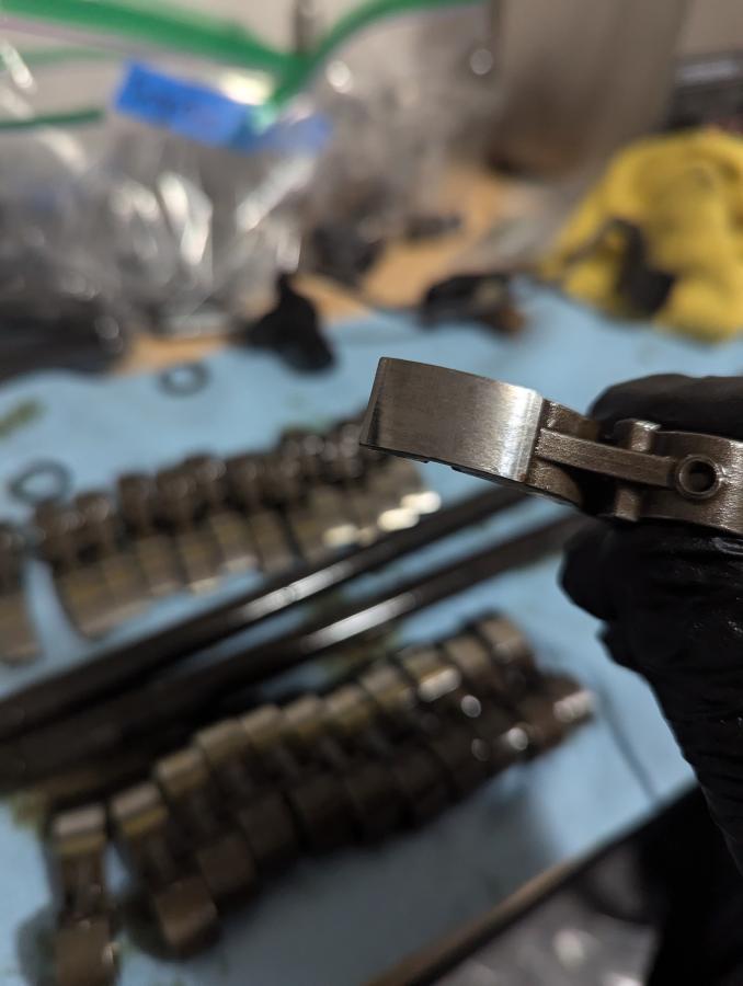

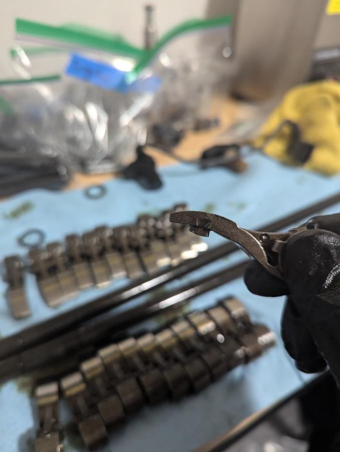

                            Quick update as the head is off the car/apart atm. Here's a photo of the rocker from cylinder #6B (rearmost) exhaust valve. This is the one where the ticking was coming from. Maybe I'm going crazy, but I don't see any issue with the rocker. Any other thoughts appreciated! Let me know if I'm missing something!
