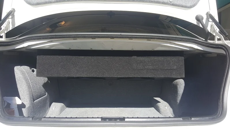

      Could do something like the old BSW box, and mount it to the top of the trunk, granted you don't run an x brace in the rear.
        I kind of like this.
        I know it says 06-10 but I'm sure you can bust it out with some card board, mdf, and jigsaw.

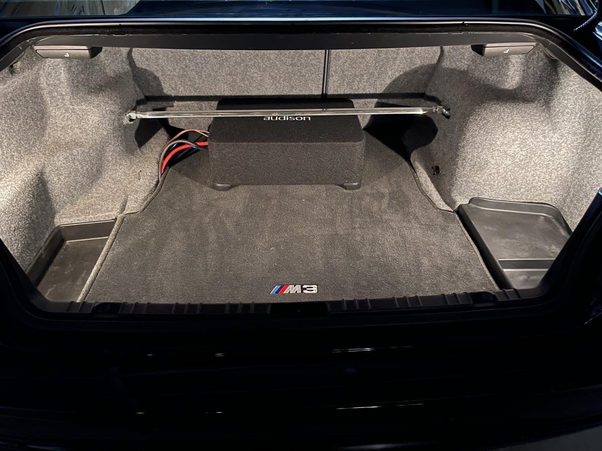

            After trying out the factory 6x9 location with upgraded 6x9 woofers I immediately took them out and purchased the Audison 10” powered sub below and its night and day difference.

                        I'm running this. I like it.
                        BMW - E46 M3 323 325 330 2Dr Coupes If you wish to buy this item with a subwoofer, click on the image and you will have additional purchase options.
                          I have one like this one for sale if you are interested. It's modeled off the wicked CAS box. Spec'd for a JL Audio 10W6v2 if I remember correctly.

                            This is the Audison powered sub i installed. Wires are now covered so looks cleaner.
