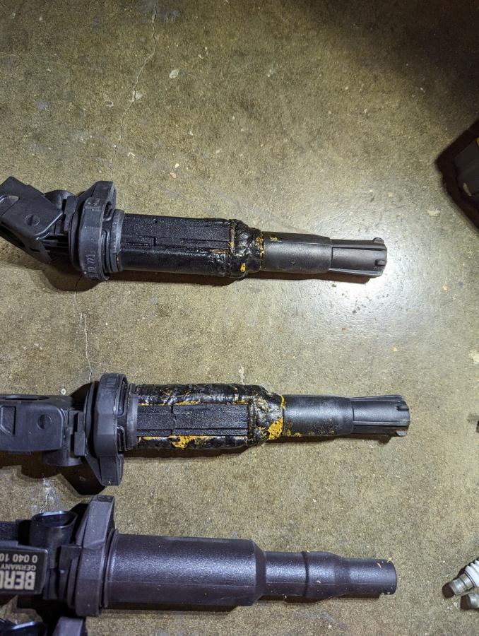

Ignition coil failure?
I'm pretty the set I purchased the car with had 3 of them looking like that, from what I gathered, it's normal for these cars. I replaced all 6 of mine because I wanted to refresh them anyway but it didn't give me any issues.
I'm curious if it's the heat that causes a few of them to deform because the plastic is hard and not disintegrated, it's just warped.
Which two cylinders did you pull those from Simon?
A few people have posted pictures like this of the original Bremi coils. Another person posted this SIB on another site:

I swapped mine when I rebuild the engine. My previous coils have been on the car since before I owned it (10+ years) and they still look like new. They were Delphi.
BMW had dual source for these parts, Bosch and Delphi. Others may also produce quality parts, but they did not come factory equipped.Originally posted by BTB View PostBumping this up … check out what I found …
Cylinder 6 coil looks like a corroded battery terminal. The other 5 were perfect. I replaced with one of the older Bosch one I had leftover. It's an Eldor (OE according to FCP)
They were overheated by the ignition copper coils inside, but this only could happen if the DME circuit or firmware is not normal. Does it have stock DME code or tuned code? A very long dwell angle ignition timing could cause the overheat, or a "bad" DME doesn't turn off the coil driver chips with engine off key turned on, then they will be overheated or burnt coils.Originally posted by simonnim View PostHas anyone seen this happen to ignition coils before? I swapped to a new set after I found this but, I've never seen something like this happen. Also, no misfires, but kinda weird idle at times maybe?
As far as I know it's stock DME coding. Minus the 6MT swap coding.Originally posted by sapote View Post
They were overheated by the ignition copper coils inside, but this only could happen if the DME circuit or firmware is not normal. Does it have stock DME code or tuned code? A very long dwell angle ignition timing could cause the overheat, or a "bad" DME doesn't turn off the coil driver chips with engine off key turned on, then they will be overheated or burnt coils.Last edited by simonnim; 04-18-2024, 01:29 PM.
Yeah those would have to have been overheated from within, with i'd assume accompanied by bad misfires or hesitation. Valve cover would not cause that as there is an air gap. Can't say I've seen this before, so interesting.
