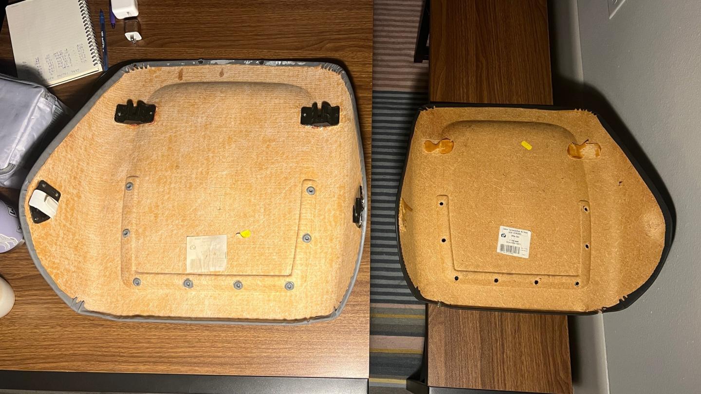

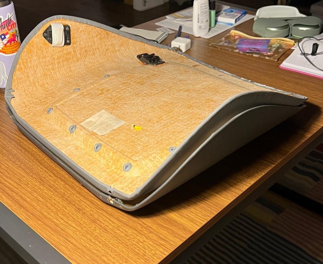

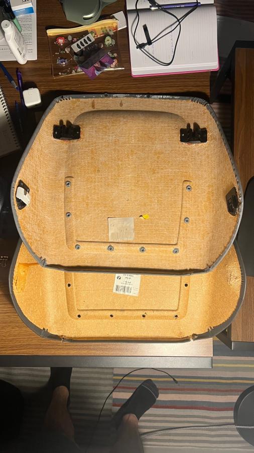

                    HoDoo I guarantee they are exactly the same. I was able to stack one on top of the other perfectly. Pics for reference:
                    Left is my E46 seat back panel and the E63 one is on the right

                    Stacked on top of each other

                      Wow... these pictures are evidence that the two rear panels are perfectly same!
                      I'm really happy and grateful to have learned this new information thanks to you.
                      I'll make a purchase and try fitting them once.
                      I'll write a review afterward.
                      Thank you so much for providing the photos and explaining everything so kindly!😊

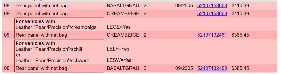

                        I hope this helps others on this forum with a similar predicament. With more and more parts becoming NLA, the quest to find reasonably priced, OEM alternatives becomes harder haha. I almost feel like a thread should be made with OEM alternatives to NLA parts if there isn't one already. I think that would alleviate headaches for some people here lol
                        For anyone else that may read this, below are the part numbers for the E63 6 Series Seat Back panel. Again, these are compatible alternatives to E46 Sport/M3 seat back panels.
