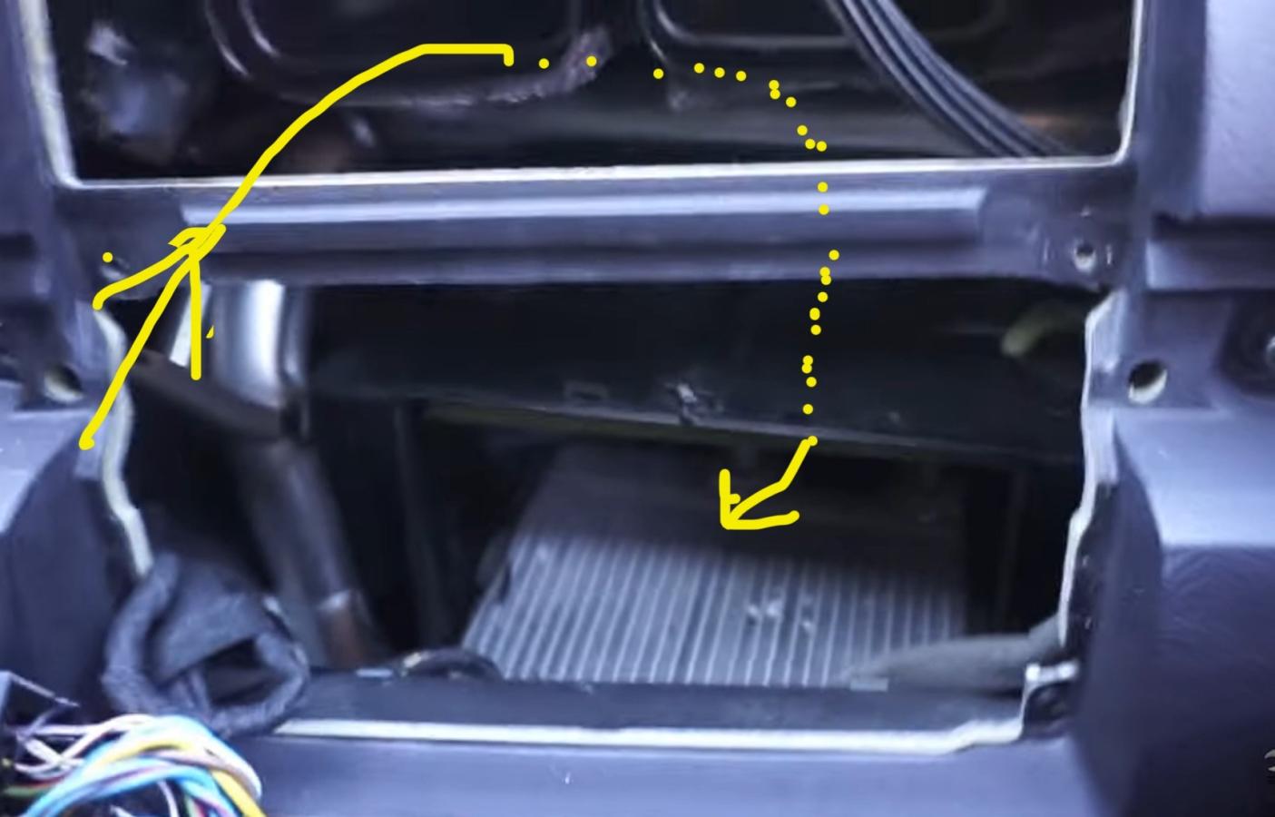

                        So I just did this probably the easiest possible way using Klima cleaner pro. Try at your own risk…
                        1) Removed center air vent
                        2) car on, AC on, flaps set to mid position only
                        3) Reached one hand into the opening to feel for flaps and used the same hand to guide the spray tube around them, feeding it as far as possible
                        4) ignition off
                        5) disconnect battery to avoid electrical shorts
                        6) connect can to tube and spray away
                        7) I let it sit for at least 20 minutes and noted that there was initially a lot of dripping from the drain underneath the car but it had stopped by 20 minutes.
                        8) reconnected battery and aired it out per the instructions
                        Obviously I wasn’t able to see how well the evaporator was coated but that is the point of the foaming nature of this product. There was a sort of sound of foam filling a cavity. I’ll report back on how well it worked on the musty smell. Included is a pic of what you’re trying to achieve with the tube routing

                              The foam seems to have worked. To clarify a point in my earlier post, the horizontal exchanger is the heater core, while the one next to the blower is the evaporator
