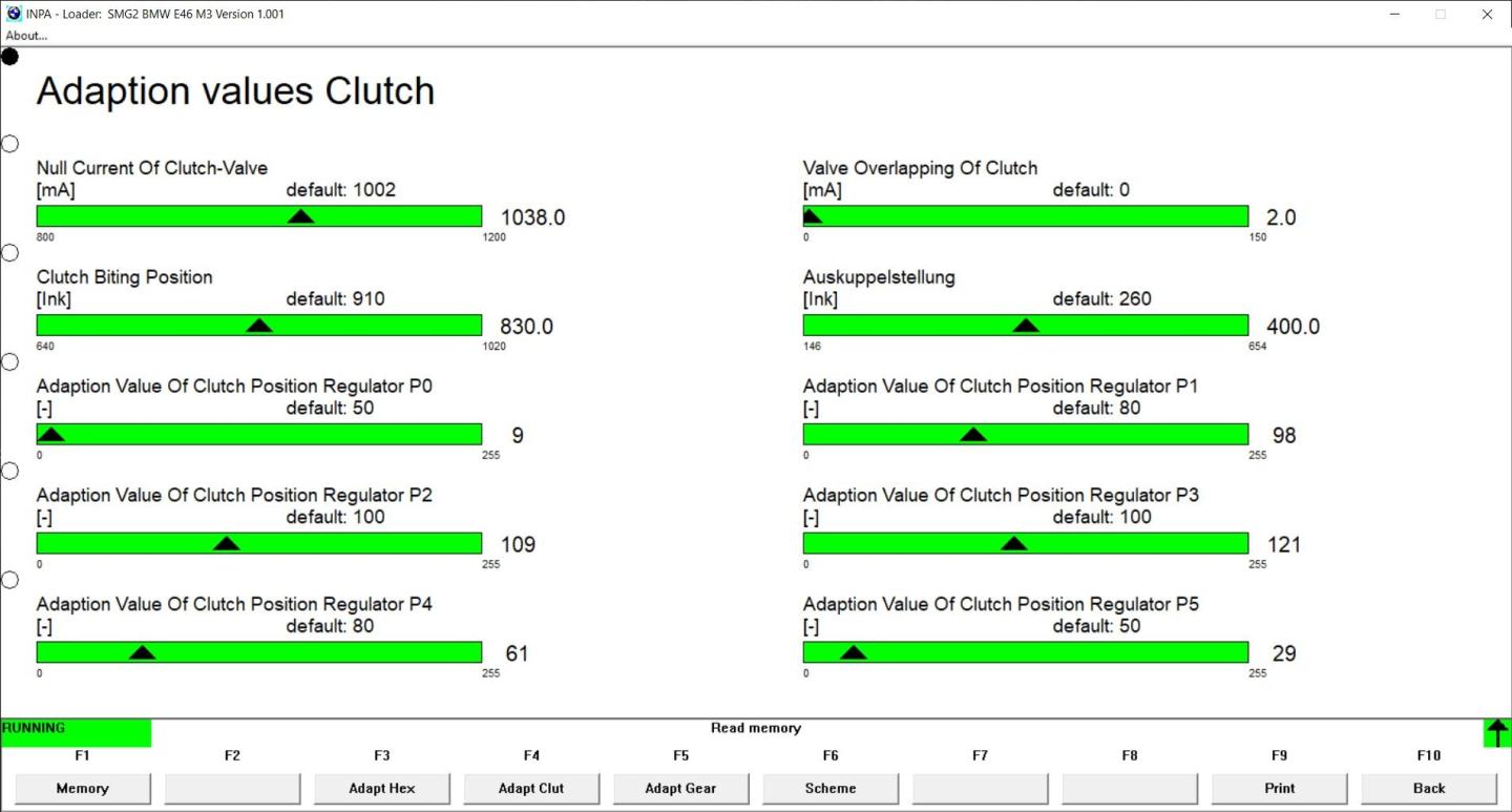

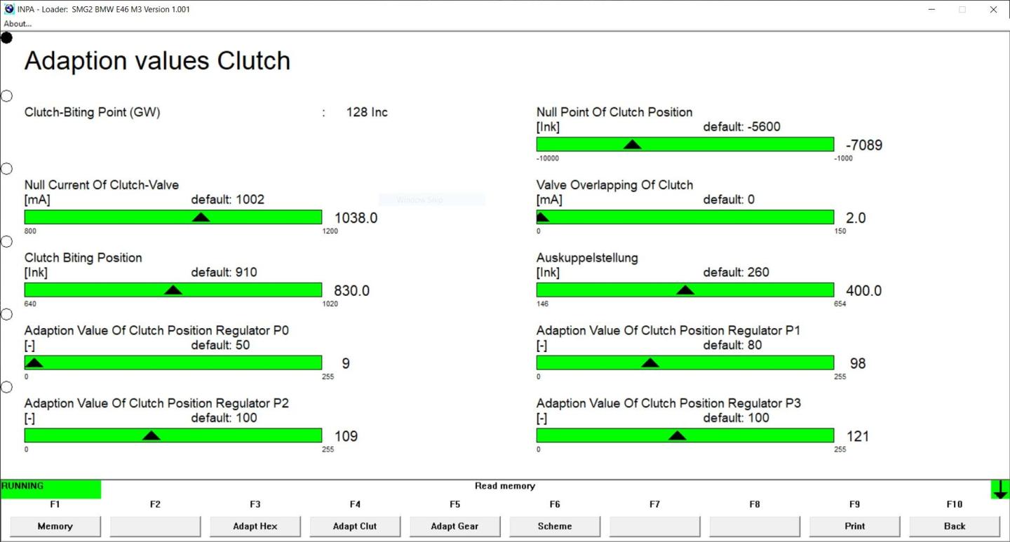

                        BACKGROUND: I have like 3 years on my hyd. pump seals, (I THINK the solenoid seals were changed at the same time (?)) and maybe 4 years on my Burkhart motor (with fresh CHF). If I push the car hard for several auto OR manual shifts, (85 mph up), I'll get the yellow cog light. USUALLY that's all I get and it continues to run OK, but sometimes from a traffic light move off it'll shift to neutral but if I wait maybe 5-10 seconds and move the stick in and out of gear, it'll go back into gear and move fine, but I'm cautious from there until I get to where I'm going. I carry a simple Code Reader that I can use to clear the code (P1717 (?) I think. If I have my laptop, INPA will show a 56. When I clear it, I'm good again for a good while, (days), as long as I drive it easy with reduced shifting. It's as though there's a maximum number of shifts that I can get before I get the cog again and if it's hot out, I'll possibly get the shift-out-of-gear scenario.
                        QUESTIONS: When I finally pull the trigger and get my pump relocated, and because I know that neither the Gear Selector OR Clutch Actuators were NOT rebuilt or replaced during my 12 years of ownership, is this not a good time to rebuild or replace these two parts while the system is open or is it recommended to just wait for these to fail? Also, are quality rebuild kits available for these parts? My clutch bite feels weird at times but when it was last available to inspect, my clutch disk and plate surfaces looked great about 15k ago and I do not launch or anything brutal in gear transitions. I maybe put 4k a year now & I don't track this car. Not fully understanding INPA, I see 'Solenoid Valve Shift Paths' for the gears and 'Solenoid Valve Open Clutch' data (that states that the clutch is being 'correctly activated', but I don't know that I should interpret that to mean that all is well. I see a The 'Nominal', 'Actual' * 'Difference'. On my last check, for the Clutch solenoid, I saw Nominal of 400, Actual of 420 and the Difference of 23. I do not know what that means but that is says, 'Clutch being correctly activated'. Any suggestions guys?
                        As usual, thanks in advance!
                        TR
                          #42
                          TR
                          1. Once your pump fully pressurizes at idle how long does it take before it has to re-pressurize (no shifting and monitoring via INPA)?
                          2. Get DIS (what was around pre-INPA) running on a virtual machine and test the accumulator.
                          3. If the accumulator, motor, and temperature sensor are good then its likely the seals have gone bad. MLREng and Burkhart are the go to for seals, motors, o-rings, etc. I'd probably go MLR for new seals. The other option is to try Burkhart's fluid.
                          4. I'd let the actuator go till failure if it was me but if dropping the tranny I understand the thought process.
                          5. I'd let the gear position sensor go to failure.
                          6. Nobody, that I've come across, fully understands the implications of default/nominal versus your current true values with respect to what is good, bad, or indifferent. My values below
                          Click image for larger version  Name:	clutch-adaptation-values-nominal.jpg Views:	0 Size:	103.2 KB ID:	266104
                          Click image for larger version  Name:	clutch-adaptation-values-nominal-part-2.jpg Views:	0 Size:	108.3 KB ID:	266105

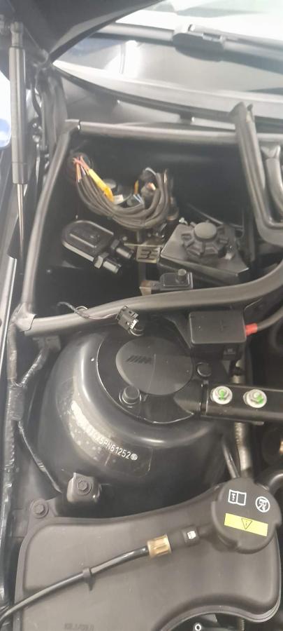

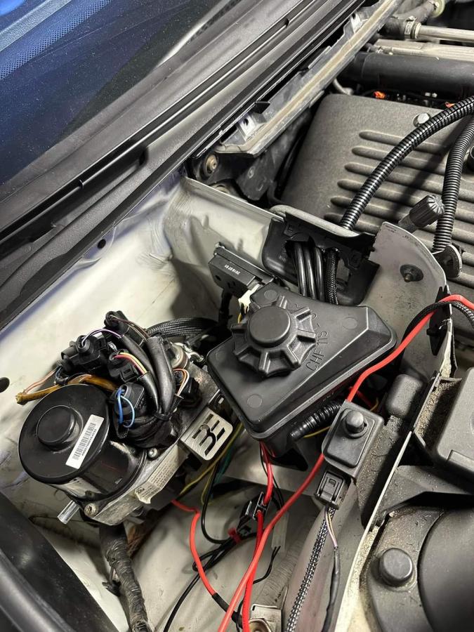

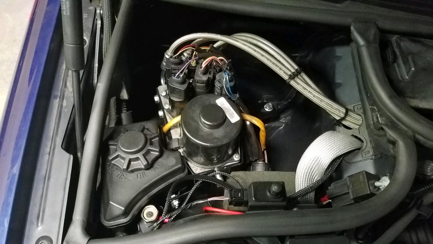

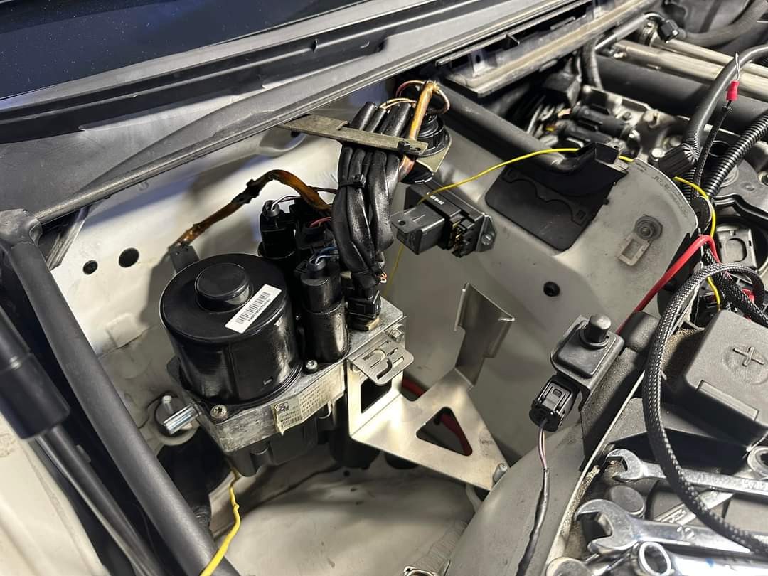

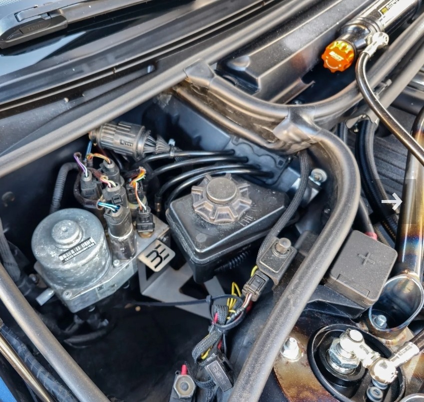

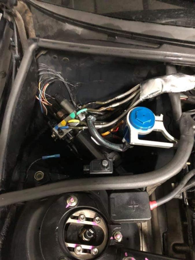

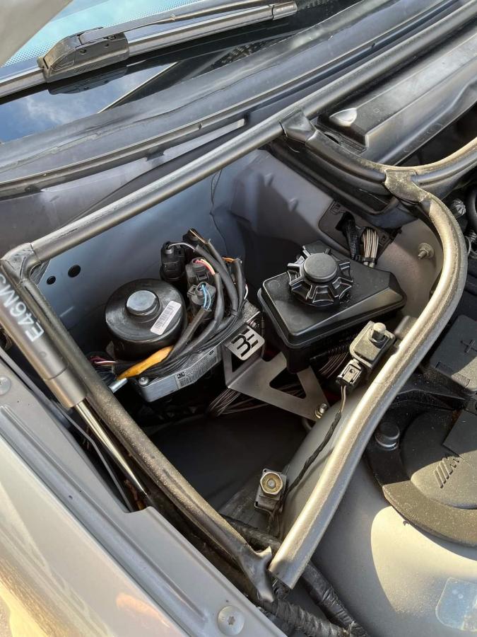

                            Here are 6 different relocation pictures I have collected for the drug bin location. Mine is the last Pic. Absolutely the best SMG maintenance/mod I have done. No issues at all. 124k miles now. Made this relocation at 105k. You will hear the pump prime when you open your door, I like it.
