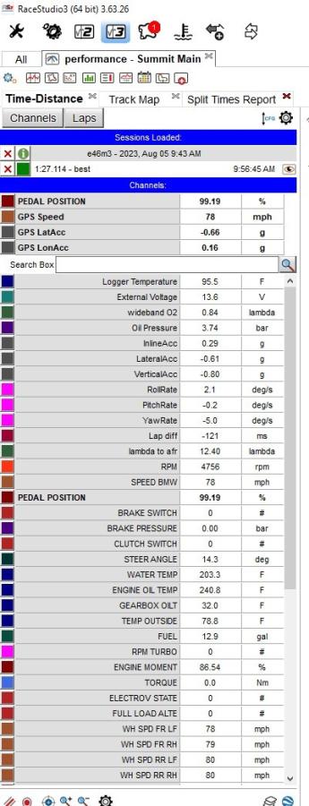

        I attached a screenshot of the data streams.
        I'm getting fuel level and outside temp data. I don't know if it's calculated or not, but AIM getting it from somewhere, and the values do change. From what I remember, the values were reasonably close.
        For comparison, it also shows gearbox temp, but it is always at 32.0 F, regardless of what weekend.
        The wideband/AFR and oil pressure are from add on sensors.
        And please ignore the slow laptime, I was not driving that well.
          Hmm, maybe its an MSS54 vs MS42,43,45 thing. But either way. Disconnect the cluster and that info goes away.
