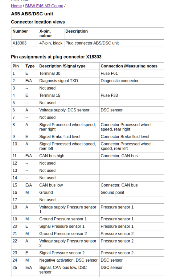

    Not necessarily, I did an INPA brake fluid flush on my MK60 without any connection to K-line. Only the can bus was connected to transfer information.
    I also revisited the connector pinout of the MK60 as I did not recall K-Line from doing the conversion. There's no pin for K-Line.
    The EDIABAS API (what's under the INPA hood) is written entirely with the DS2 protocol in mind, which is exclusively used on the D-Bus (K-Line). As Heinz points out, CAN isn't even accessible from the OBD-II port.
    CAN is used for high speed inter-module communication between the cluster, transmission controller, DME and DSC module.
    BMW calls it TXD in their wiring diagrams. Pin 2 in the pinout Ted posted.
    Here's the entire TXD1 (goes to pin 8 on the OBD II plug) bus:

    Looking at the MK60 pinout, it has a connection to CAN H/L and D-Bus:
    -Ted
