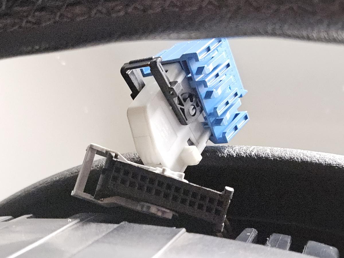

So, one downside of this is that diagnostics of remaining factory modules will be limited. When the factory cluster is disconnected, access to diagnostic functions of other modules may also not work.
Today I needed to access the LCM to change some coding options. No chance without the factory cluster connected to the K-Bus. So it is important to keep the possibility to reconnect the factory cluster in case of difficulties.
Once the factory cluster was reconnected to the K-Bus, diagnostic access to the LCM worked like usual (same for inpa and pasoft).
Although I'm still having issues to flash changes with ncsexpert: I change the options and it says coding successful, but then no changes are applied?! But this should be unrelated to the above as changing options with pasoft works...
