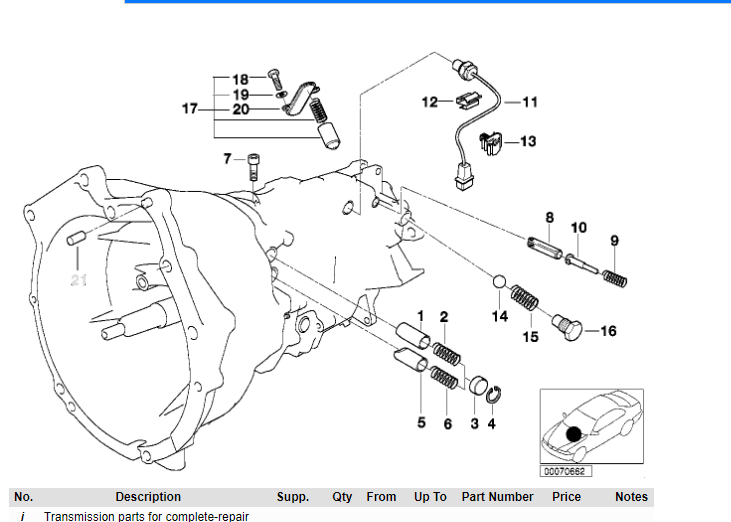

          Smg and manual both have these detent parts:
          3 under the top right rear cover.
          2 on the top left rear.
            The detent springs added during the conversion are #2 & 6
            #17 is the same for both variants as is #15
            #9 is specific to MT if the GPS is installed
            I always replace all of the detents and parts in this diagram when converting a transmission but I don't think thats a common practice. #15 is a common failure on SMG cars, don't think I've seen it fail on a MT car though.
            Either way though #15 & 9 are relatively cheap, #17 is the one thats going to hurt your feelings.
