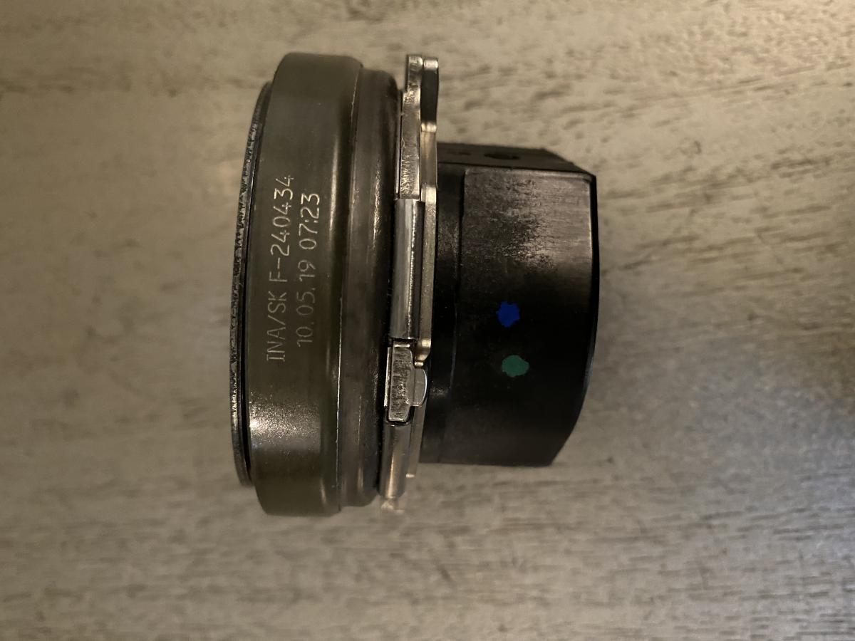

                      Following up on this..the Sachs kit includes the wrong TOB. No biggie since the kit is only $313 on FCP, and adding the correct TOB will still be cheaper than the Luk and OE kits.
                      997.1 GT3 Carrara White/Black
                      C43 AMG Diamond Silver/Red​
                        Can you clarify- is that a picture of the tob that comes with the sachs and luk kits or is that a picture of the genuine bmw part you had to order?
                        I see it says INA and SKF, both of which are OE teir brands that provide original equipment for our cars like the pulleys/tensioners and flex disk, for example.
                          It’s the TOB that came with the Sachs kit FCP sells.

                            So I wonder who the actual manufacturer is of the OE genuine BMW part, because INA and SKF are quality brands.
                            Anyone have a photo of a genuine bmw branded TOB?
