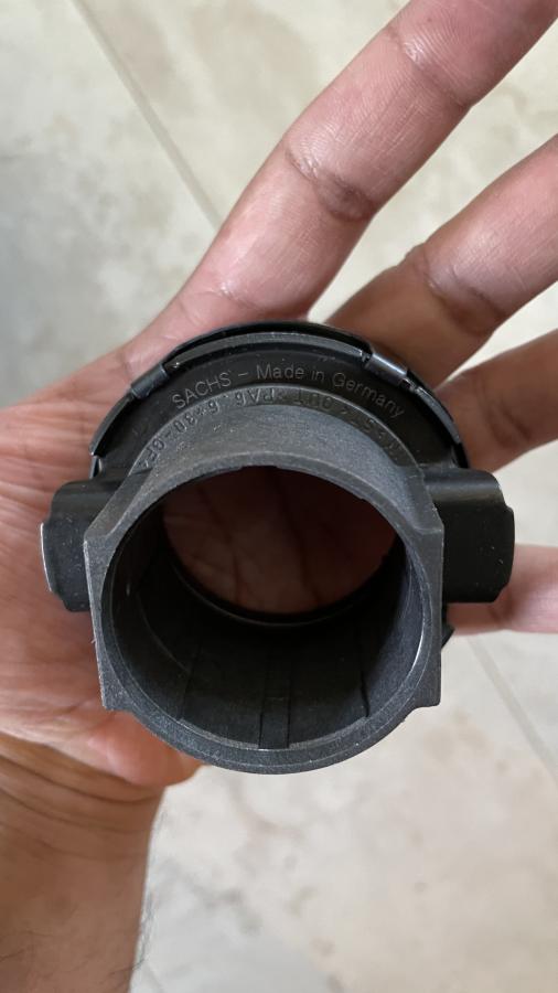

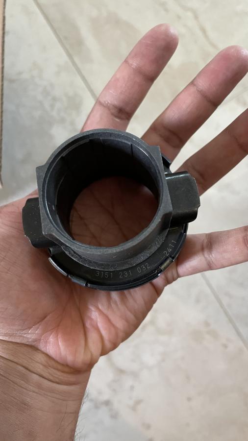

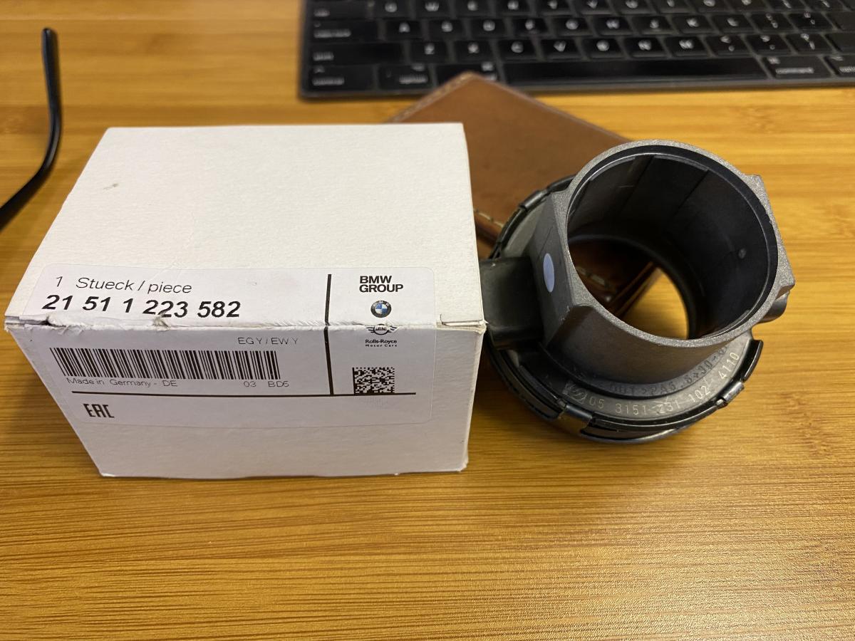

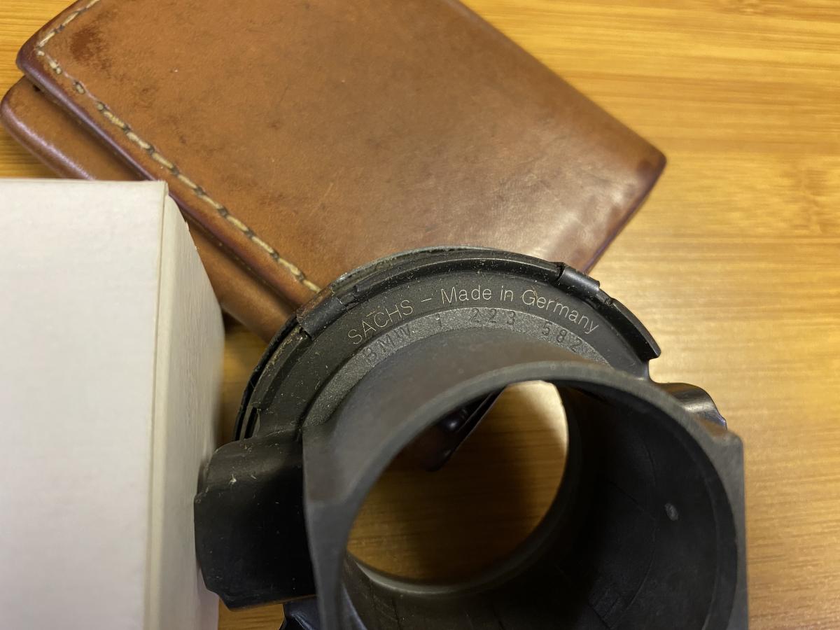

        here are some pics of the stock, OE throw out bearing. Made by Sachs as mentioned in here.

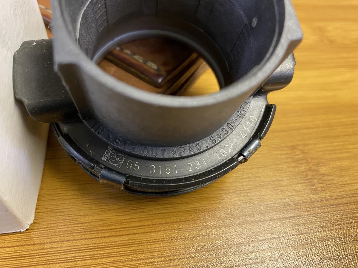

          And a Sachs TOB from FCP:

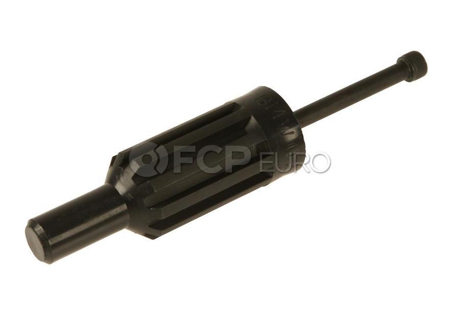

            Anyone have the correct clutch alignment tool they are willing to loan out? FCP is telling me the Sachs kit I ordered doesn't come with it and it's on backorder from Germany currently. Happy to cover shipping to/from
              I can loan you mine, but I would like it back when you're done. However, before I ship it out, it appears you're located in Denver, so you may want to check with https://www.denverbeerandoil.com/ and see if they have one you can borrow. If not let me know, and I can ship it out.
                Thanks man. Never heard of DBO before but I'm relatively new to Denver still. I'll hit them up first otherwise will shoot you a PM if they don't have one. Much appreciated!

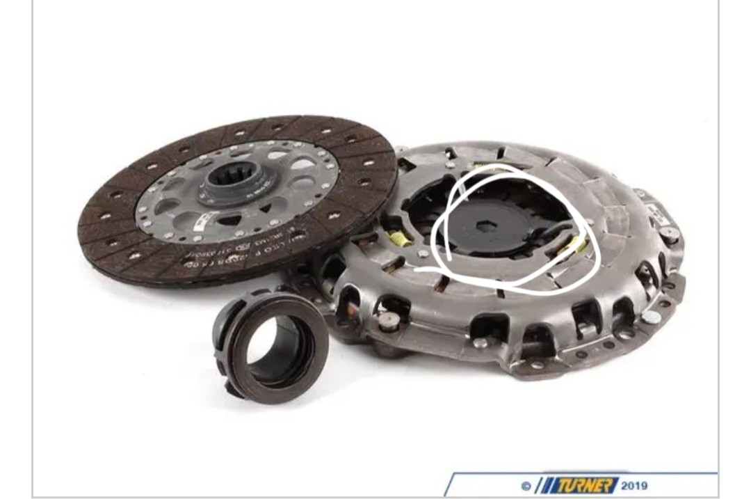

                          This may be a dumb question thread question, I've never installed a pressure plate that has a "plate" in the center as to not allow the clutch alignment tool to go in.
                          What is the purpose of this plate, keeping things aligned?
                          I assume it must come out at some point as you couldn't get the alignment tool in place in the clutch and put the pressure plate over it let alone the tranny input shaft.

                            That is for the SAC or self adjusting clutch mechanism. You bolt up the pressure plate and then twist that piece out which engages the SAC.
                            Don't take it out before tightening the pressure plate or it makes the job more of a pain. You can reset the SAC, you just need a 3 jaw puller and a mandrel to press on the pressure plate fingers. Here's a tip if you need to reset the SAC. Install the pressure plate and clutch with the 3 jaw puller on it. Snug the pressure plate bolts to the flywheel enough so the SAC will reset but you can still move the clutch disc a little bit by tapping with a hammer/chisel or screwdriver. Just a touch past hand tight. Remove the 3 jaw puller, use the clutch tool to center the disc and then torque the pressure plate bolts.
                            The risk here is you won't know it worked until you install the transmission.

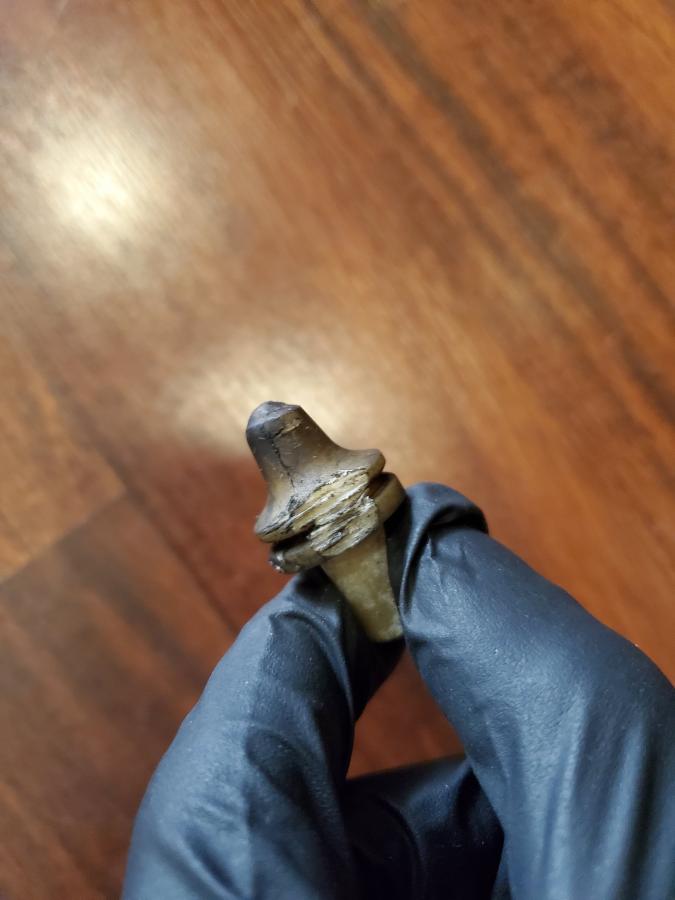

                              Interesting how there seems to be so much variation. Maybe it's an effect of failures being more compelling to report? Regardless, I'll update this thread with the condition of my pivot pin when I do all of this.
                              Did you finish this project and what's the condition of the stock plastic pivot pin?

                                Yeah I swapped the clutch a few years ago. Haven't had the transmission off since, so no idea how the replacement parts are wearing. This is what the original pivot pin looked like (ignore the marks on the side, those are from the vise grips I used to get it out):
                                I swapped the starter on my car about a year before doing the clutch and didn't have an issue getting it off either time. It pulled right out once the bolts were removed.
