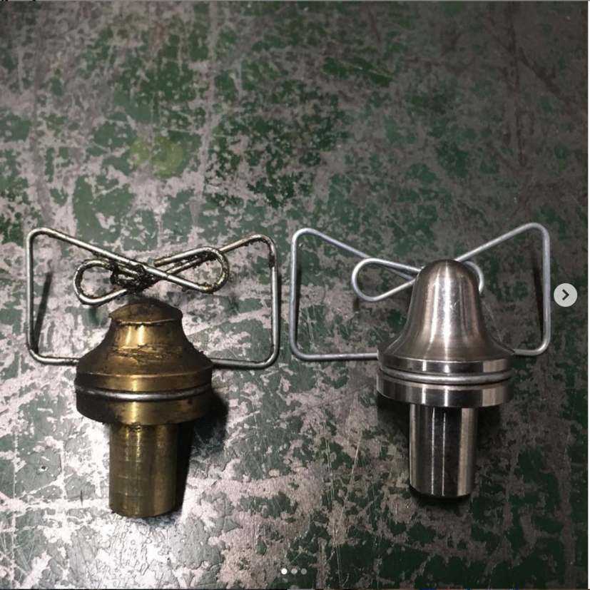

                    When the ZF 5-speed transmission swap was done on my car, I inquired with my mechanic about installing the brass pin. He doesn't care for them as the brass can deform. We went with the Rogue Engineering stainless steel pin:

                      Metal pivot pins add nhv. If that’s worth it is up to you. Personally I’d replace with new plastic— failure is pretty rare. If you do go with a metal one, I’d use the OE BMW metal one.

                        There's a reason the factory pin #21511223281 is steel

                            On metal pin, IF you are going with metal, def don't do brass, do steel.

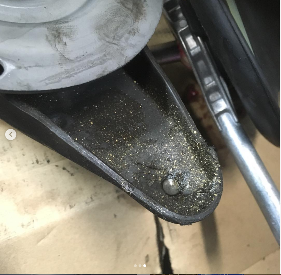

                              +1 my brass one looked like Kaivs after 20k miles.
