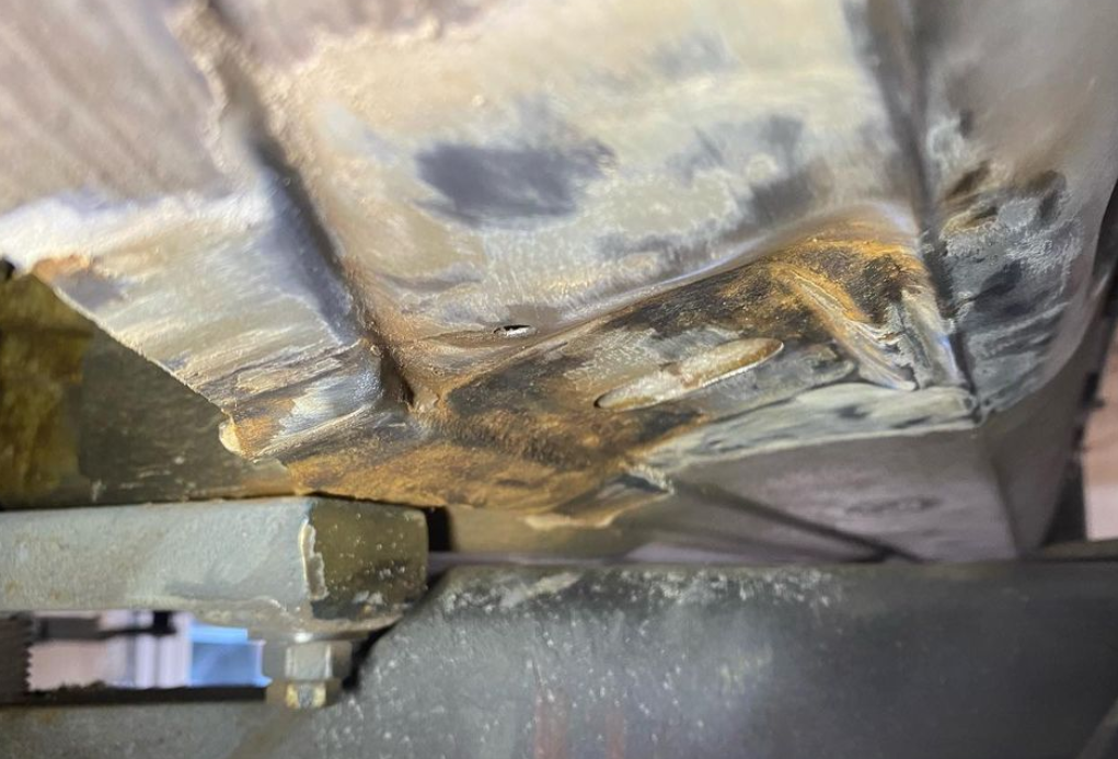

          I don’t think it has ever been publicly acknowledged, the cases of extreme rust originate from this though, because the jack pad tips in on the on the outside, the overlapped section on the inside opens up a bit, which allows moisture to get in and rots out the jacking point.
          This is what happens to the jacking point if you just lift one rear corner with a floor jack, the outside tips inwards, it is supposed to be parralel to the arm of the lift.

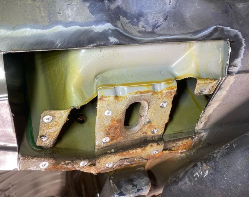

          If we cut away a part of the outer section we can see the structure within, the outside curves upwards further and is attached to the outside of the panel with 2 more spot welds.

          For the reason why this only happens to the coupe, we cut open a sedan that was going to be scrapped and we found that there's an additional support on the outside of the jacking structure (exactly the part that fails on the coupes) which goes further upwards.
          On the coupes this entire part just simply isn't there, I don't really know why.
          Click image for larger version  Name:	jackpoint3.jpg Views:	0 Size:	174.6 KB ID:	269078

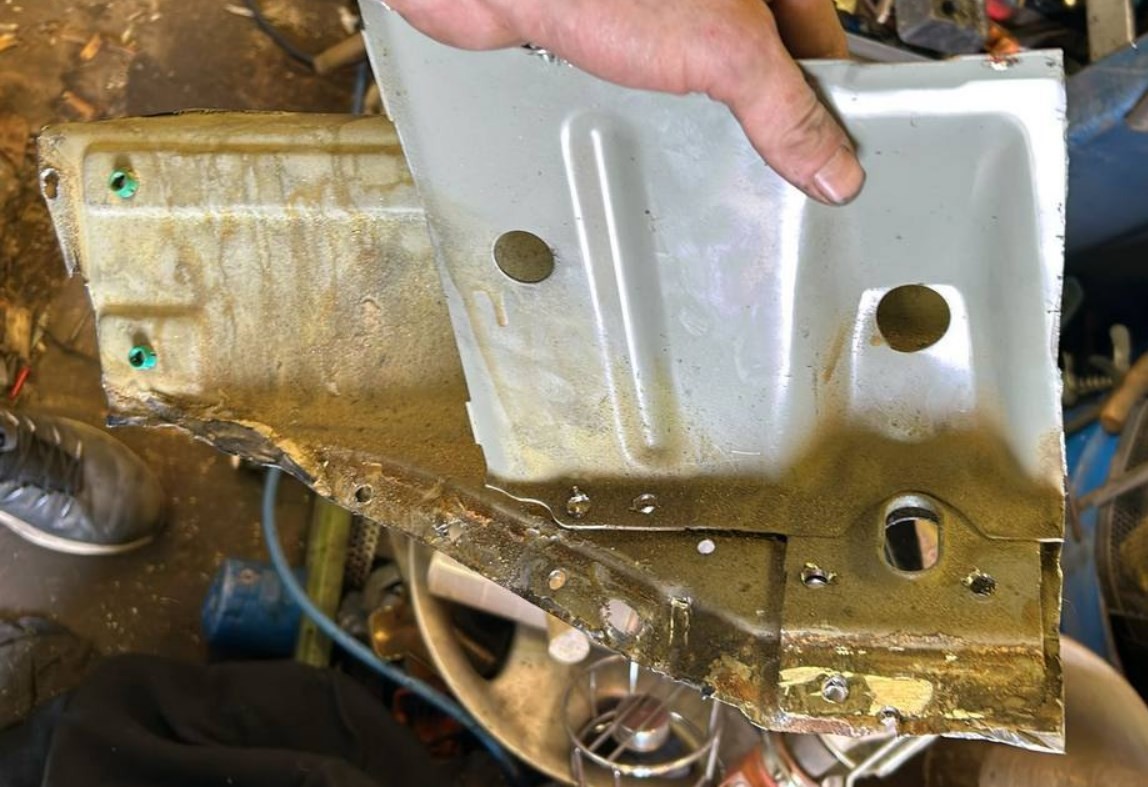

            The other confirms in photos as was said these rust out. Then become damaged. I’ve had over 100 E46s on lifts and have yet to come across any with damage there in SoCal. I mention region because I don’t see rusted cars. This is my caveat. I do however know these do get damaged from seeing and reading feedback worldwide and rust. This is especially true in Europe. Companies make and sell this section of metal just to replace from rust damage. At all four jack pads and not just rear. But rears are most common rusted out area. Here’s one I know about from before showing those same plates and areas. You may find it interesting.
            Four jacking point in rocker panel fits for E46 coupe, sedan, touring . You get 4 jacking points repairs kits . Front left side, front right side, rear left side, rear right side. FL + FR + RL + RR - 2 x4 - 8 parts. Parts of the sill you can find in parts

              old///MFanatic
              As I said in my first post, I believe the rust to be a result of the problem and not the cause.
              If you look at the second picture I posted you can see only the outer (super thin 0.8mm) panel was rusted a bit, which I believe happens because of the bends the metal makes the paint and sealer cracks and flakes away.
              The internal much thicker support plate was pretty much not affected by rust.
              So I am not 100% sure if we can blame this on rust, the evidence I have seen suggests not.
