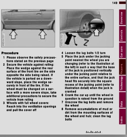

                  It is. The other E46s come with a factory jack that actually is made just for using any of the four factory jack pad locations.
                  The BMW accessory “Emergency Spacesaver Spare & Jack” kit come with similar jack and same use instructions.
                  Click image for larger version  Name:	IMG_0289.jpg Views:	0 Size:	83.2 KB ID:	268234

                                BMW TIS only shows jacking up from the front center jack pad and raising the car on a four post lift. I could not find any info on jacking up from one of the side jacking pads.
