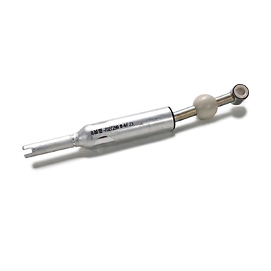

    Anyway, I opted for the Autosolutions SSK, the entire assembly. (Billet arm, selector rod, as well as the shift lever.) I believe it’s a 35%, or maybe it’s 90% because that’s what it really feels like. So notchy…
    In other words, it’s coming out ASAP. It feels wrong how crisp and notchy it is, or at least not my cup of tea.
    Is there a way to get a very slight throw reduction via OEM means?

    Getbmeparts has a "OEM short shifter" I paired it with the AKG selector rod and it was smooth. I forget which BMW shifter was used though.
    Autosolutions is quite responsive I even called after texting him. I'm sure if you message him your situation he will gladly help solve it.
      I used the BMW performance shift lever on my Touring conversion - part number 25117527259.
      This lever is apparently also used for the diesel 3 series (330Cd, 330d) and is somehow slightly different that the E60 545i shift lever that other folks have also used. It does slightly position the knob/lever off-center but it is really not that noticeable.
      I paired this lever with a Rouge Engineering delrin front carrier mount and all other new OE bits, including the selector rod joint/foam/pin assembly. Shift action is really nice and I have zero complaints.
        Can't comment on the feel compared to stock shifter as my car came with a different SSK installed, but the 545i shifter can be swapped in while retaining all the other stock hardware.
        '04 LSB Coupe 6MT
          You want the 545i shift lever as stated above. It's what DINAN used to offer as their OEM short shifter option, IIRC.

                  I definitely will be going back to the OEM shifter, with the original throw. Even debating going to the 330d or 545i shifter as I’m not sure I want the reduced throw. It almost feels like a chore to get it in gear sometimes.
                  waiting until the car comes back from paint to try it out.
                  Curious if my OEM shifter lever will fit into AS carrier with their rod…will revert back once the car comes back.
