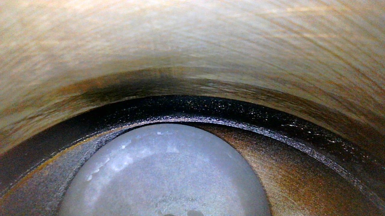

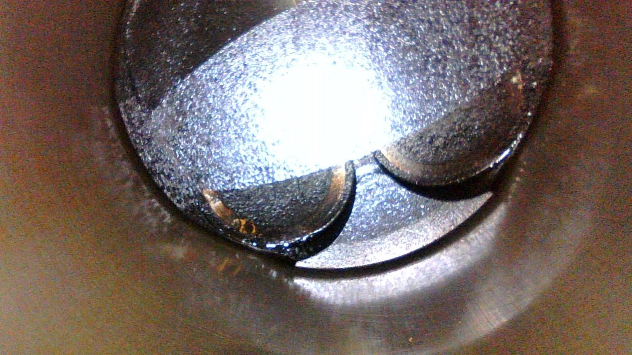

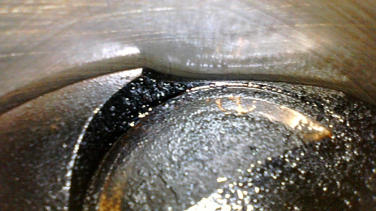

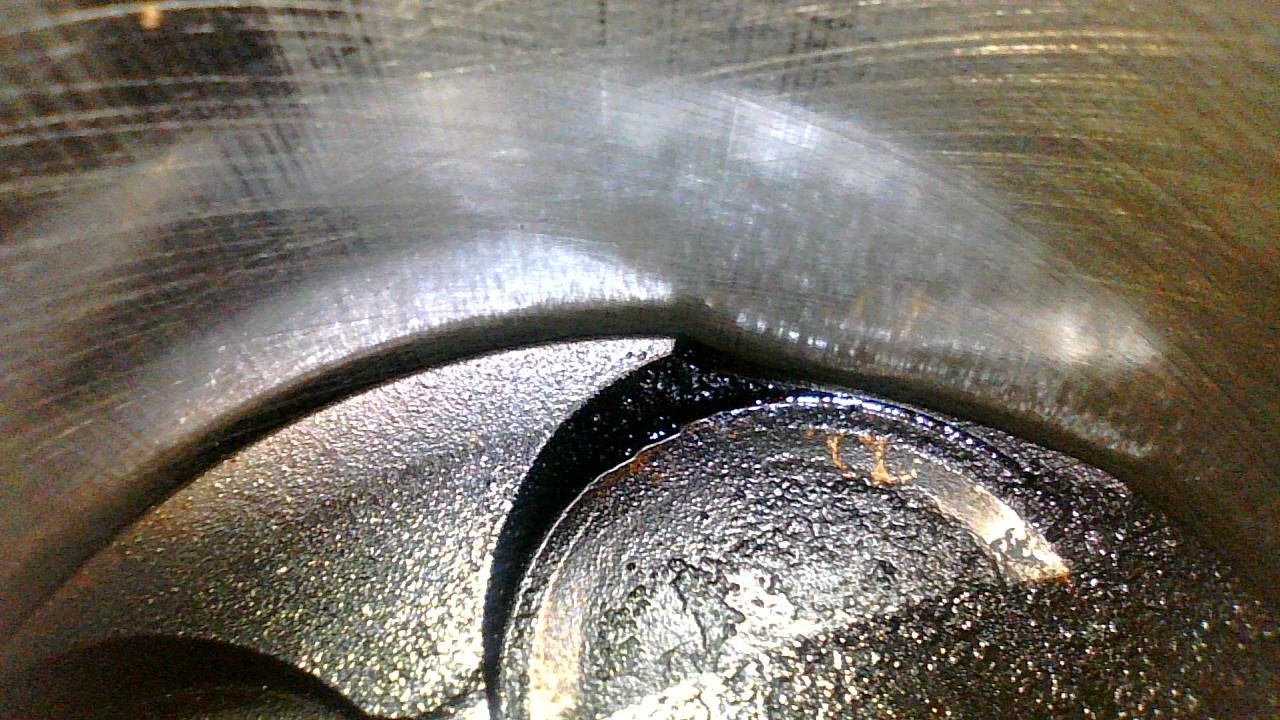

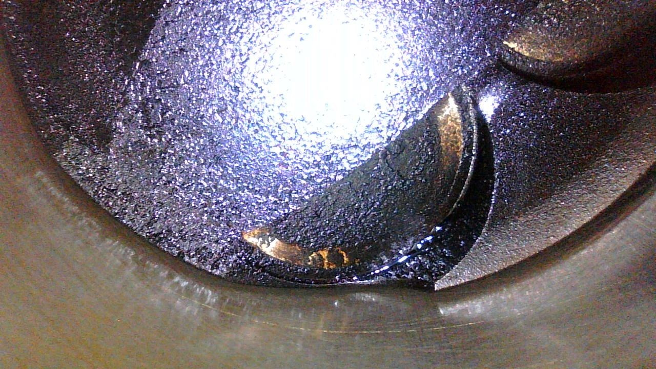

Probably doesn’t have anything to do with having a skimmed head and decked block, there is plenty of margin there, but I suppose with aftermarket components I am not sure.Originally posted by BMWfanz View PostUpdate: valves reached the pistons. Will measure valve lift without cam and spring in TDC and post results soon. Seems like I have no valve clearance after head and block machinery.E46 ///M3 • 12/2002 • phönix-gelb • 6MT

I can confirm the JE pistons have more than enough valve relief. I didn’t measure the stock pistons but with .003” taken off the head and .005 taken off the block, I had 10.8mm piston to valve clearance at TDC on the intake side(adding in 1mm for safety, so 11.8 before contact). This is enough clearance to run any production cam offered for the s54, even the Schrick high lift or Cat cams 14.5mm lift cam.
sounds like a timing issue, not piston related.
