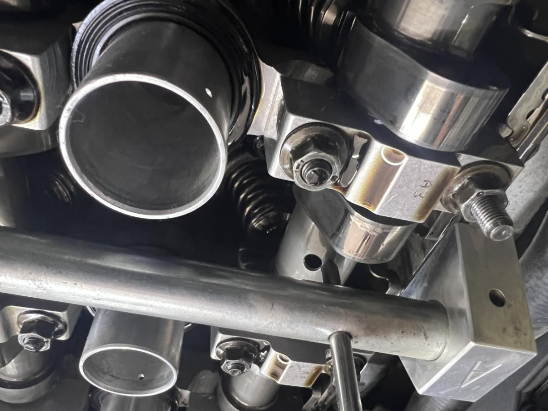

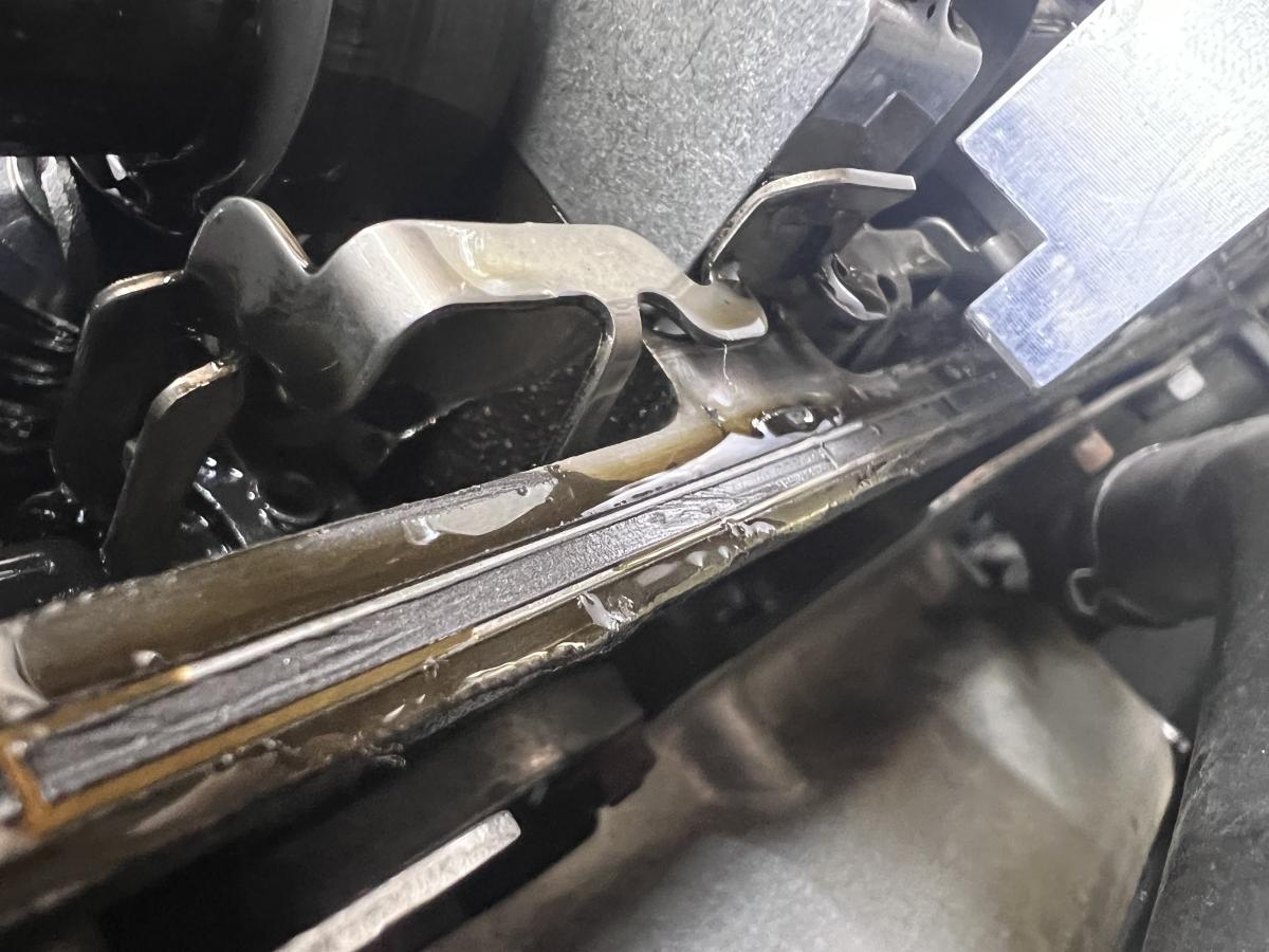

    Let me clarify: 17 degrees range was on exhaust vanos was the reason why I retimed engine. When I started checking timing- it was so wrong that exhaust pin was missed, I have a photo too ( see pin position and plate position on second photo). I've drove on it maybe 2-3k kilometers on wrong timed engine.Then I retimed engine. When I disassembled vanos I"ve marked vanos spindles and when tried to install it on marked position- it wasn't in sweet tooth position, on marked tooth only half of the range as I pushed spindle by hand. Then I"ve done timing procedure again, installed pins, checked valve hubs maxim right position as tis said, marked sweet tooth position, pulled vanos pistons maximum inside of the vanos module, then installed vanos, torqued 2 hub bolts, rotated engine 7-8 circles, checked the pins position with timing tools, then again rotated engine 3-4 times- checked with final tool (which is 1 pin) as tis said and completed procedure. Then after 20 mins of engine work i launched tool 32 and vanos test. I was sitting in a car with laptop and when exhaust cam retard on 45-48 degrees- valves were bented.

                      1. I have a photo too ( see pin position and plate position on second photo).
                      2. When I disassembled vanos I"ve marked vanos spindles and when tried to install it on marked position- it wasn't in sweet tooth position, on marked tooth only half of the range as I pushed spindle by hand. Then I"ve done timing procedure again, installed pins, checked valve hubs maxim right position as tis said, marked sweet tooth position, pulled vanos pistons maximum inside of the vanos module, then installed vanos, torqued 2 hub bolts, rotated engine 7-8 circles,
                      3. checked the pins position with timing tools, then again rotated engine 3-4 times- checked with final tool (which is 1 pin) as tis said and completed procedure. Then after 20 mins of engine work i launched tool 32 and vanos test. I was sitting in a car with laptop and when exhaust cam retard on 45-48 degrees- valves were bented.
                      1. The pic proves the theory that the EX piston hit the cover cap at -111 deg instead of max retarded -83: 111 - 83 = 28 deg crank, so cam deg is 14 deg different, which the pic shows.
                      2. I read your steps and it's not clear to me if you had done it right. List in detail all the steps involved when it was done.
                      "pulled vanos pistons maximum inside of the vanos module, then installed vanos, torqued 2 hub bolts, rotated engine 7-8 circles​"
                      This seems to be the bad part: pulled the vanos piston max out means toward the rear, which is opposite of what you want to have the piston pushed to its max forward (hitting the front piston cap). If you did pulled the piston rearward to max, and then torqued the hub bolts down with the EX cam aligned with the pin, then when the DME moved the piston forward to it max retarded pos, then the cam was retarded further than -83*, say -70, then the EX valves were still wide opened when piston moved up TDC then hit the valves.
                      You shouldn't care about getting the sweet tooth as it's not causing the problem.
                      3. Yes, you had rotated the crank and check with the pin alright, but this hidden the problem and bent the valves later. Why during this crank rotating check that the piston to valves interference wasn't detected? BC the EX piston was still not moved toward the cap yet.
                      The only sure way to verify the timing is to ensure that the vanos piston hitting the cap and the cam hole aligned with the bridge pin and the crank at TDC compression. you have 2 parts right but you didn't know where was the vanos piston.
