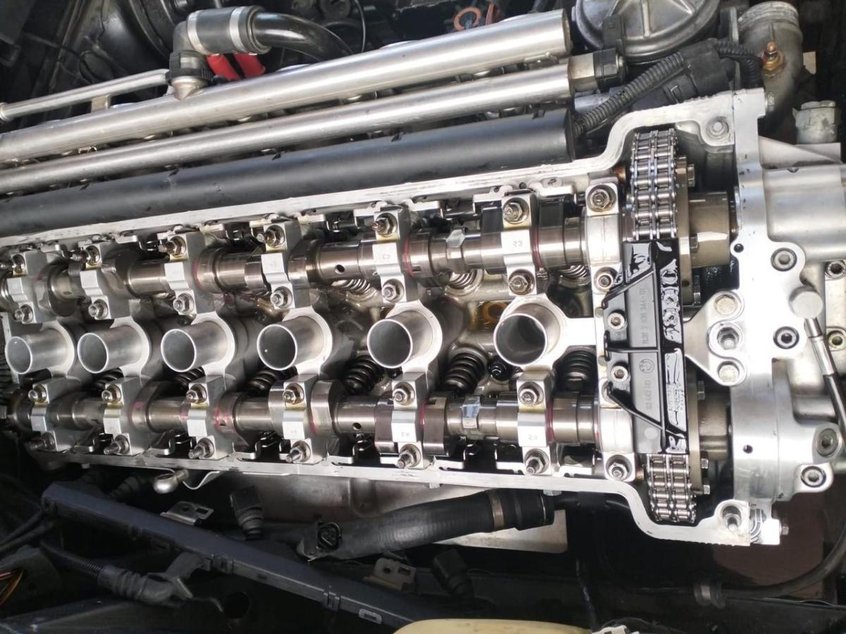

                    For me, the sure way to check the timing is to be sure that the vanos pistons are touching the front caps. So either using compressed air with the official tool to push the pistons forward, or my cheap way: remove the caps off, turn the cams CCW until pistons protrude out of the holes 1mm, then install and tighten the cap bolts. This ensures that the pistons are precisely at their timing position.

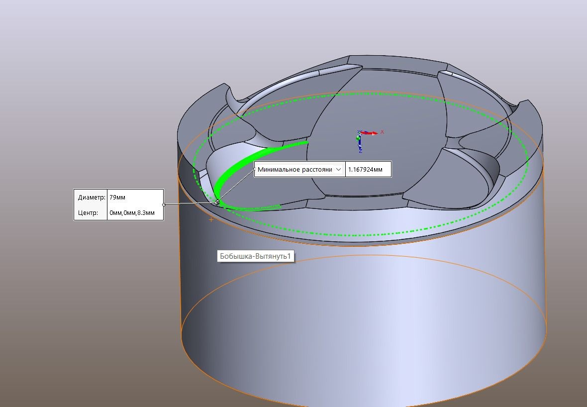

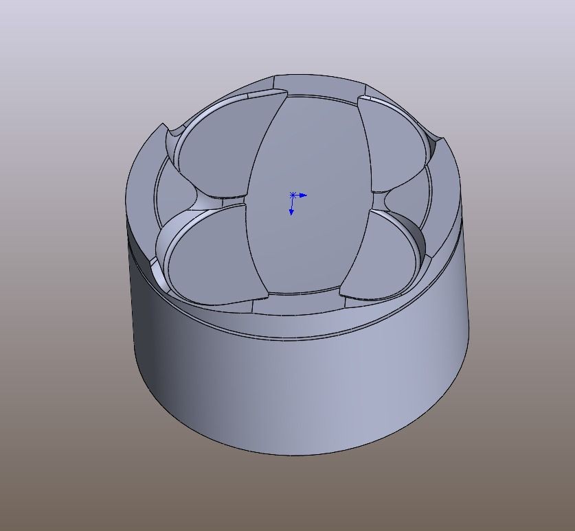

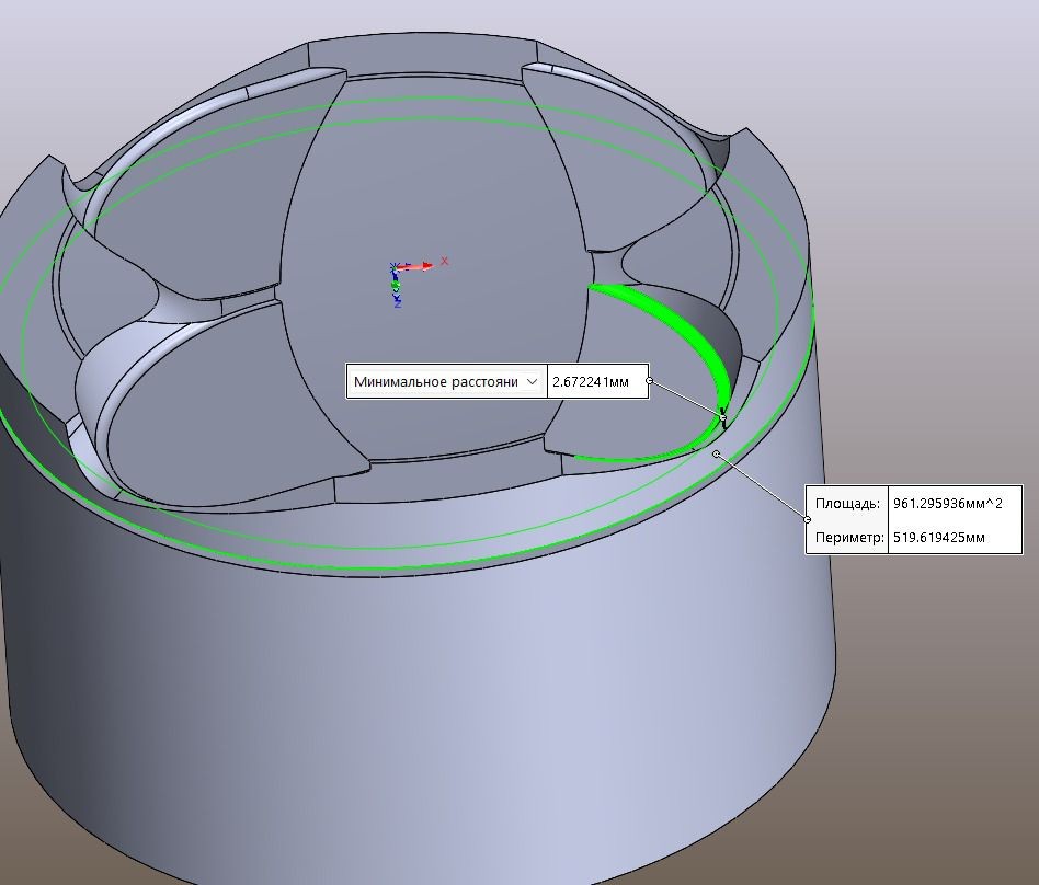

                      Update: 3d-scanned my JE pistons for checking possibility of machining valve counterbores- there is no way to do it. So my basis question is current configure of my build. Now i have no information about basic clearence between valve and piston on non-machined engine or engine with JE pistons. I dont want to buy thicker gasket to unnown thickness and drop compression ratio. So maybe someone has some notes on builded engines- i have no confidence if i buy only gasket thicker on machined compenstation height- will it be enough for my setup or not.

                          Originally posted by BMWfanz View Post

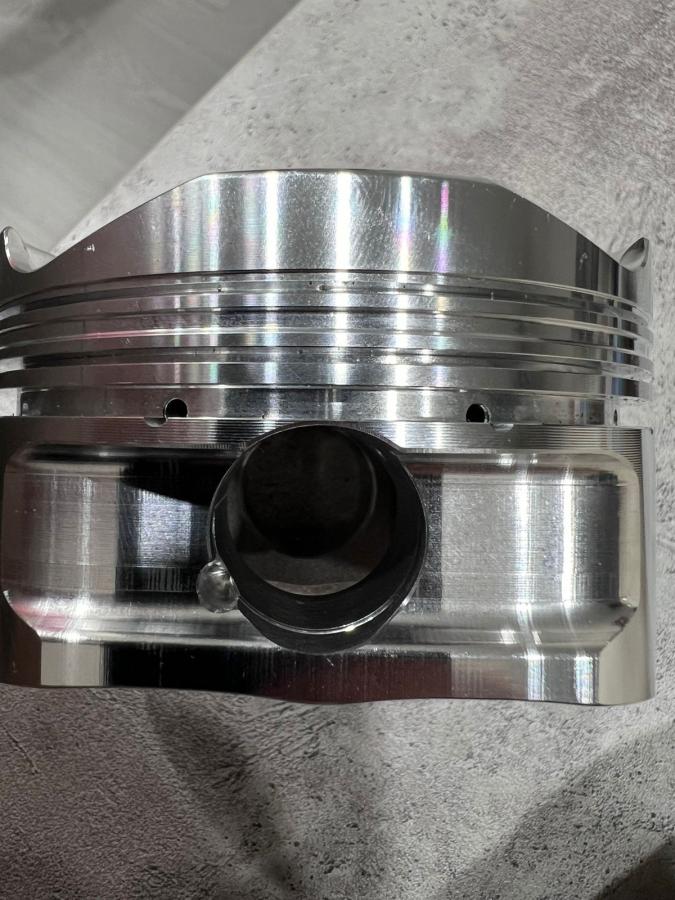

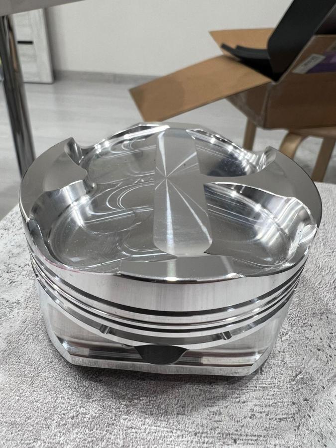

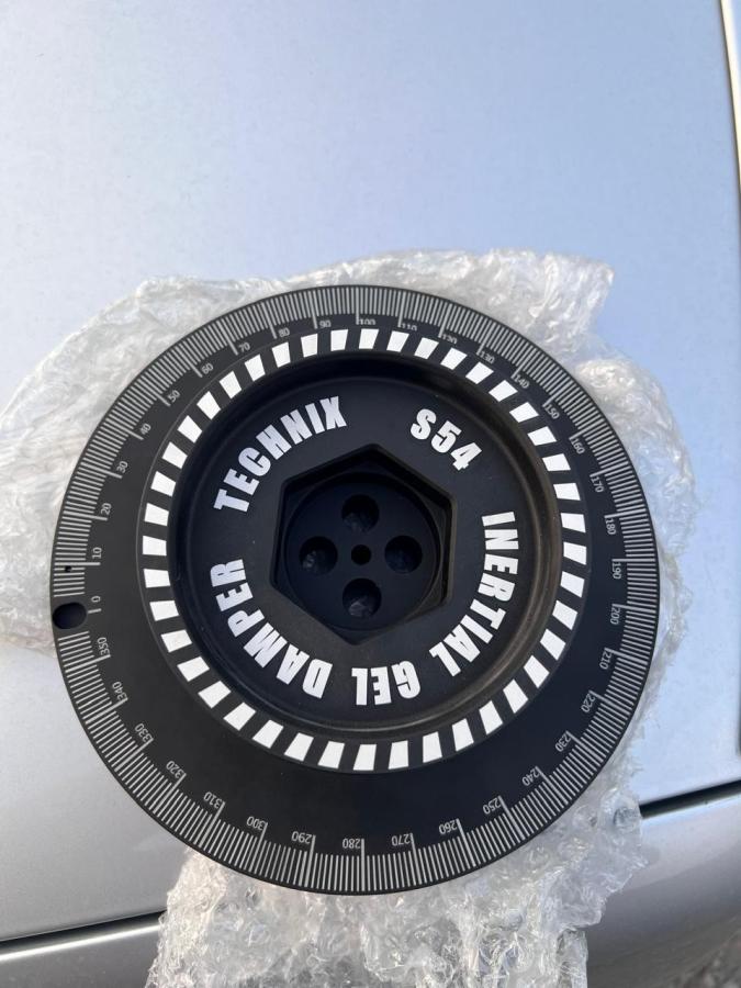

                              #44

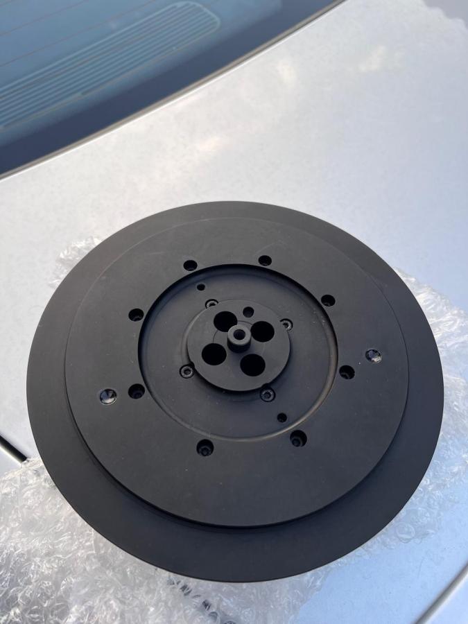

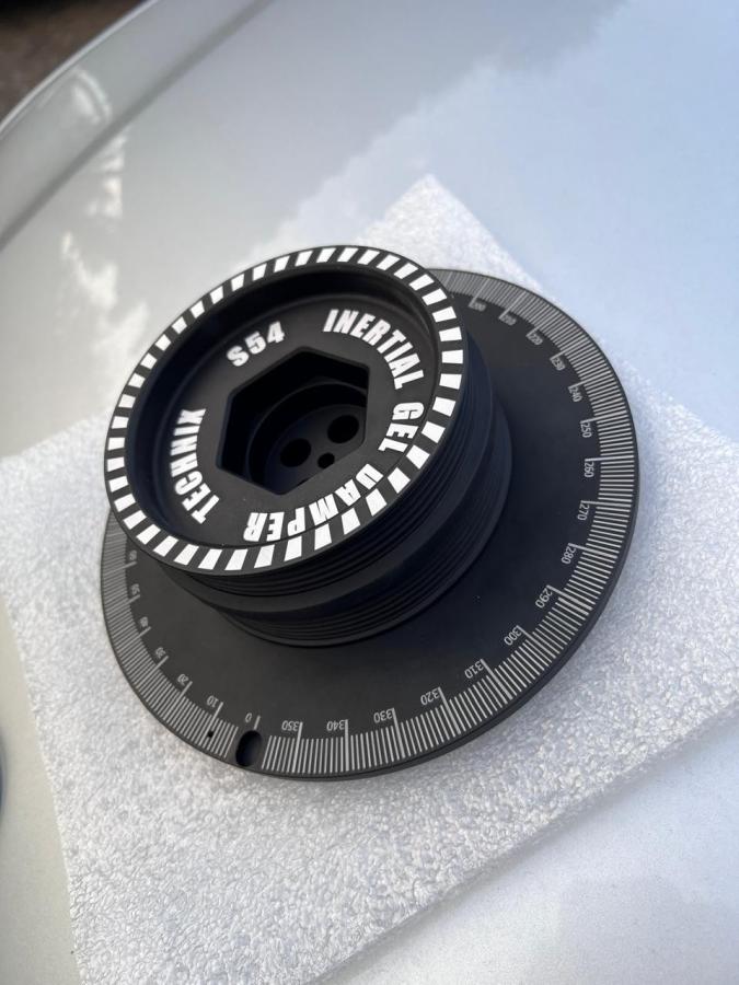

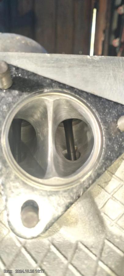

                              Ended my rebuild with new CP pistons. Pistons was ordered in LangRacing- 87.5 mms, custom releif: +2 mm exhaust, +1.5mm intake. Done Exhaust channels porting, now seems like need a bit tune. For additional installed sport damper with innertion (Better edition of ATI damper). Will post results soon, now on engine run-in for at least 1000 km.
