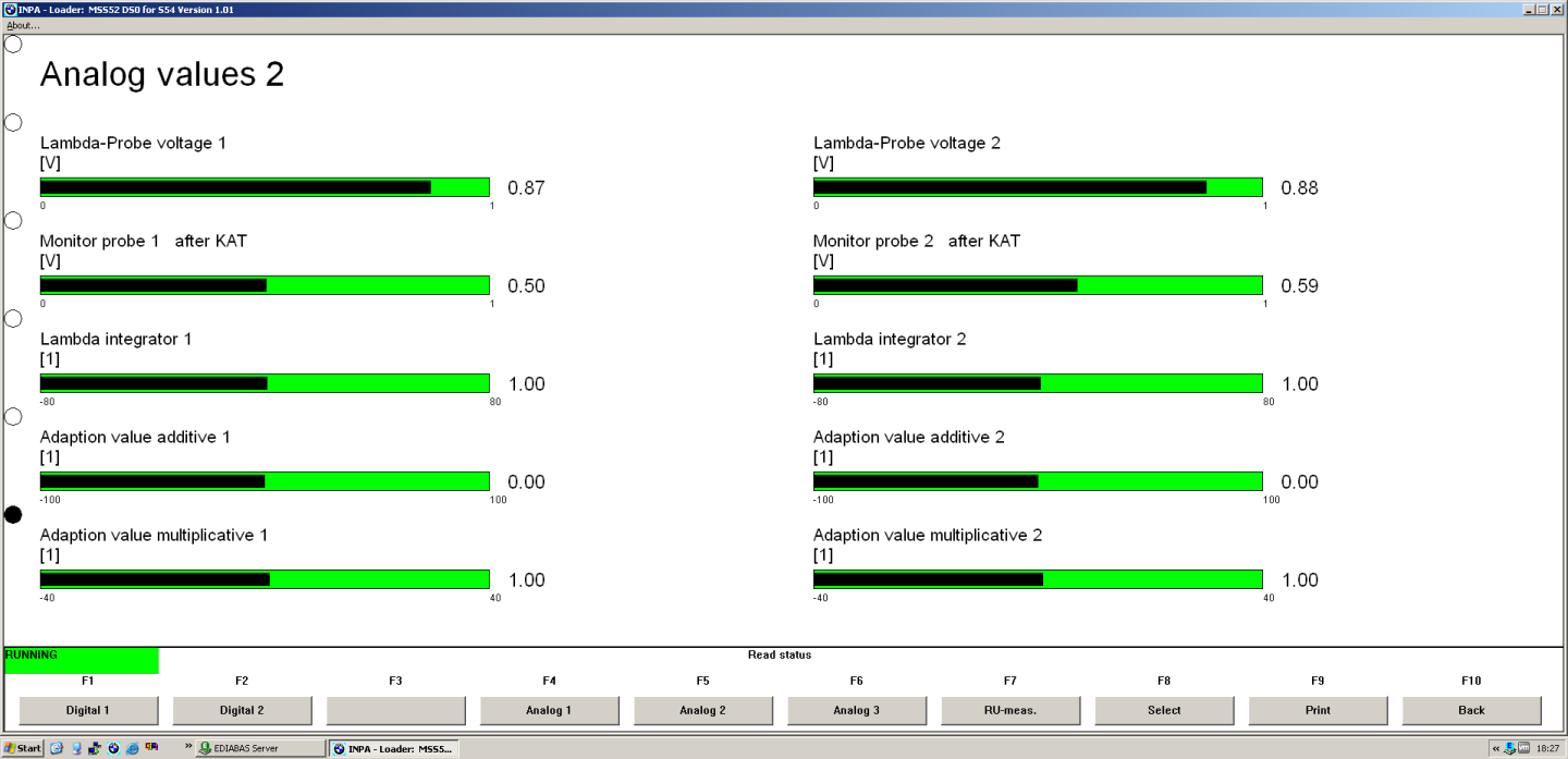

      Click image for larger version  Name:	Navcoder II-2024-06-12-18-27-40 - Analog Values 2 Engine started.png Views:	0 Size:	100.2 KB ID:	267840
      Is this enough to make a diagnosis?
      It looks reasonably balanced?
      I reset the adaptations before i started the engine.

          Half that screen you cleared by resetting the adaptations and fuel trims. What looks balanced to you anyway?
          Get the log as suggested. What it logs is what you wiped but also it is a single point in time vs logging over time.
            How do i capture logs. Is some additional software required to record INPA data?
