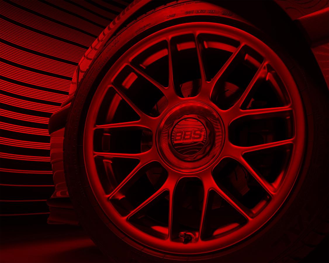

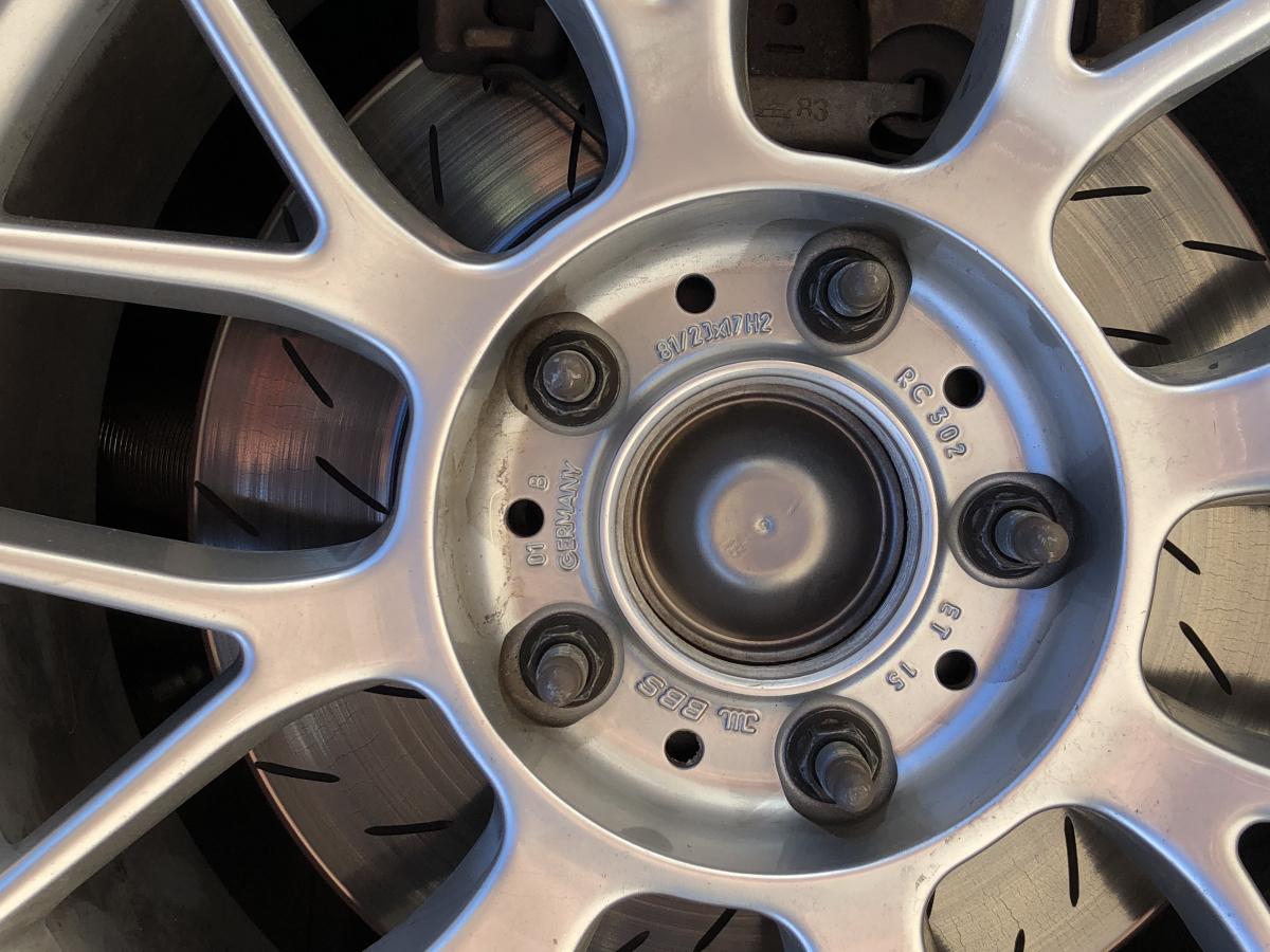

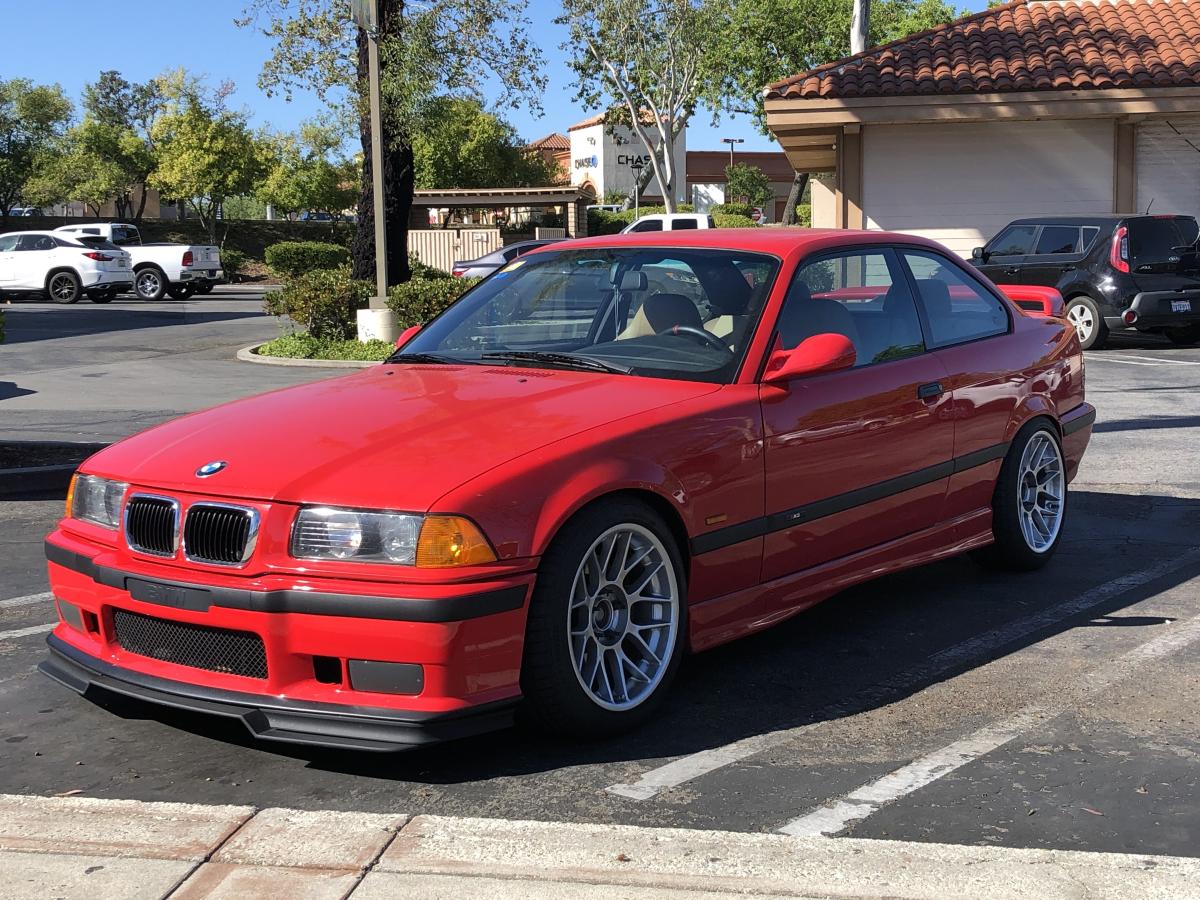

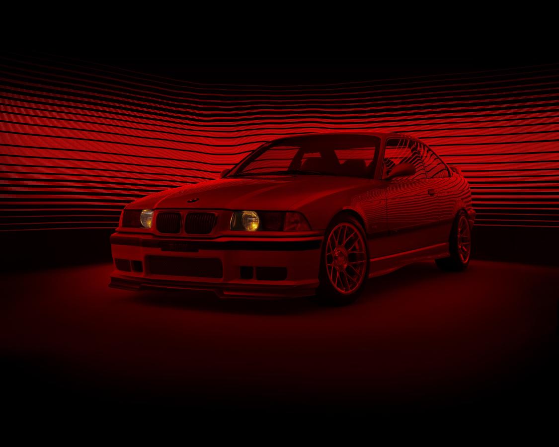

                        I’m not a BBS guru but I used to have RC302s on my e36 and I’m pretty sure those were forged. They were e34 M5 application originally I believe, with an 74mm center bore, plus a 72.5mm adapter in my case. And if you took the center caps off they look exactly like ARC8s which, incidentally, is why I only had them for a very short time. I don’t know if other RC variants have different construction. There are like an hundred different sizes and fitments including OEM VW for the RC, so I feel like it’s likely there are tons of differences. And I don’t really care if people love or hate reps or are indifferent. Just be aware of what you have.

                            No, only the BBS RCJ version was forged the BBS RC, where flow flowed (spun cast) as mentioned:
                            Name Manufacturing Method Size Weight (lbs.) Weight (kgs.)
                            BBS RC Cast (soft) 16x7 15 6.803886
                            BBS RC Cast (soft) 16x7.5 16 7.2574784
                            BBS RC Cast (soft) 17x7 16 7.2574784
                            BBS RC Cast (soft) 17x8 16.4 7.43891536
                            BBS RC Cast (soft) 17x9 18.4 8.34610016
                            BBS RC Cast (soft) 18x10 19.5 8.8450518
                            BBS RC Cast (soft) 18x8 19.5 8.8450518
                            BBS RC Cast (soft) 18x8.5 18.7 8.48217788
                            BBS RCJ Forged 18x8 17.9 8.11930396
                            BBS RCJ Forged 18x9 18.7 8.48217788

                              By the way, those BBS RC's look amazing on your e36 m3.
                                Thank you, it was a vibe but I moved on rather quickly. Interestingly, the size isn’t listed on that chart, they are 17x8.5 ET13 (maybe 15?)
