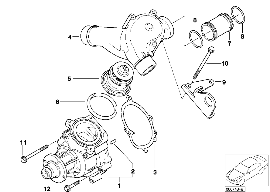

    There are only a select number of places or points where you can have a coolant leak:
    - Water pump to block gasket
    - Thermostat housing to #7
    - Between the water pump and the thermostat housing ( #6 )

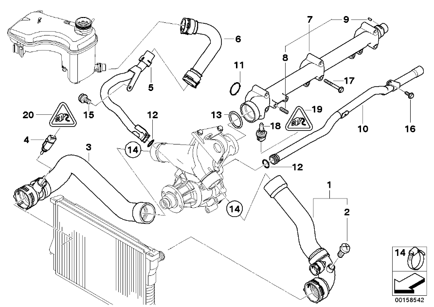

    - 7 to heater core pipe ( #7 on image 2)
    Click image for larger version  Name:	image.png Views:	0 Size:	164.9 KB ID:	268434
    -Coolant temp sensor on the heater core pipe
    - Seal between #10 and the water pump (14)
