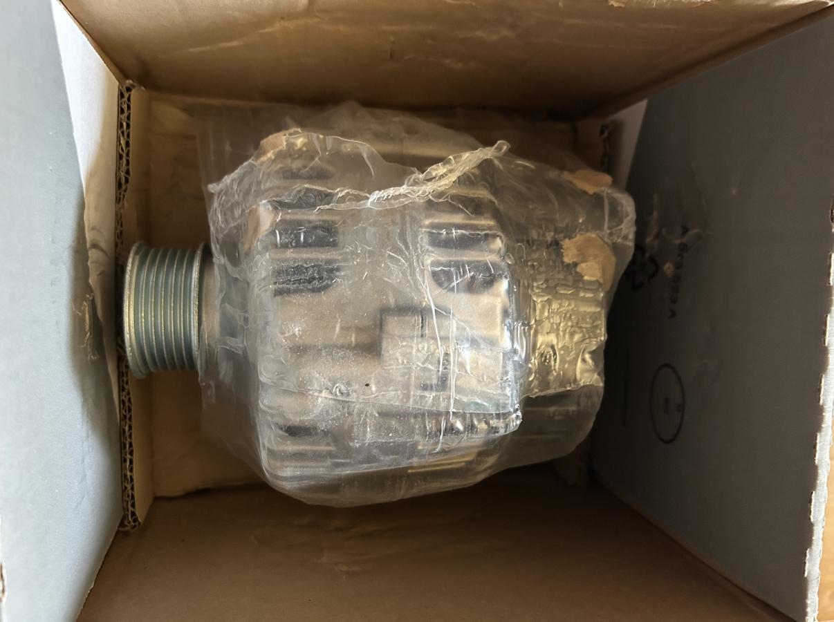

                    car has Bosch alternator from PO...he just replaced it before my purchase...but based off people's experience on here, I may go ahead and replace with BMW reman.
