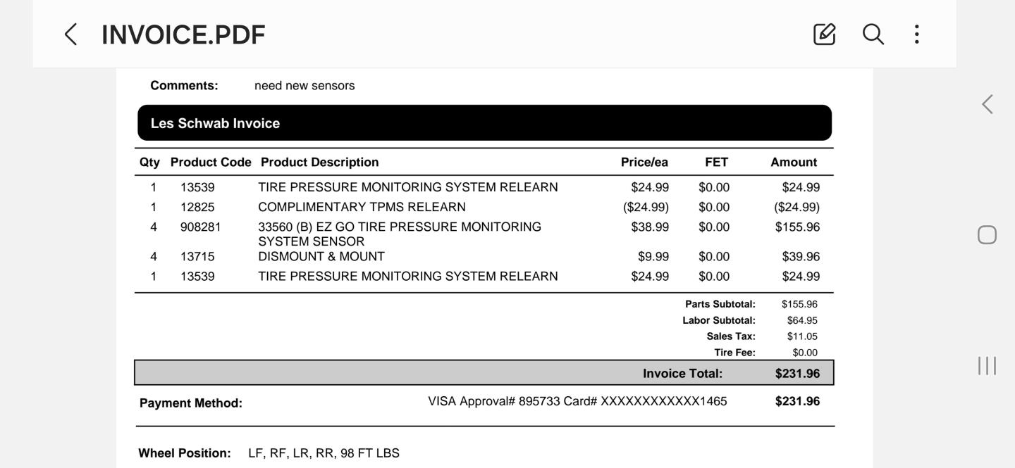

                Also took it to a tire shop to get the TPMS sensors fixed as it's always telling me I have a flat, that was $230 for 4 new sensors and reprogram of the system or whatever.

                    Originally posted by old///MFanatic View Post
                    What year is your M3? You actually have sensors in the wheels??
                    It's a 2005. It seemed to have fixed the problem.
                    There weren't any sensors in any of the wheels they said (which I understand they're supposed to be wheel speed sensors in the hubs, right?). Their system allowed them to program the new ones (33MHz I think they said) Put 4 in. Said to drive it at highway speeds for 10-15 miles should allow the sensors to calibrate and the light would go off on it's own. I did so and the light didn't go out on it's own, so I hit my turn-around point and held the TPMS button on the dash until the red TPMS light went out. It didn't come back on the rest of the trip back. Usually it'd come back after a minute or two.
                      #55
                      The E46 M3 does not have any TPMS, it just uses the wheelspeed sensors. If you read your manual, you can actually see for yourself how to calibrate these so the light doesn't keep coming on. But if you haven't got a manual, see here:
                        #56
                        https://www.youtube.com/watch?v=-zh8o1axQ_U
                        I understand that. But what they did fixed my issue. Drove 100mi today and the light didn't come on.
                        I can't explain it.
                          #57
                          My guess is they replaced all four wheel speed sensors and they or OP might be referring to them as being TPMS sensors. IIRC, a bad wheel speed sensor can cause the TPMS light issue.
                            #58
                            Here's the invoice. They showed the sensors to me, they were attached to the valvestems.
                            Click image for larger version  Name:	Screenshot_20240718_030317_Samsung Notes.jpg Views:	0 Size:	87.7 KB ID:	272350
                            Shop the Schrader EZ Sensor 33560! This Schrader snap-in TPMS is OE quality, universal and easy to install. Get the best price at TPMS.com!
                              #59
                              So where on your car is the tyre pressure displayed?
                                #60
                                It's the yellow/red icon on the right side of the dashboard. It was solid red before they did this. As I said, I'd hold the tire pressure button on the dash and the red tire light would go out, but 30 sec or so later, the dash would BEEP and the red tire light would come back on.
                                Now, I held the button and cleared the red tire light after driving down the interstate and getting off and coming back and the light went off but hasn't come back on.
                                I don't know what black magic fuckery is going on that whatever they did fixed it, but I don't have a red tire light on my dash anymore.
