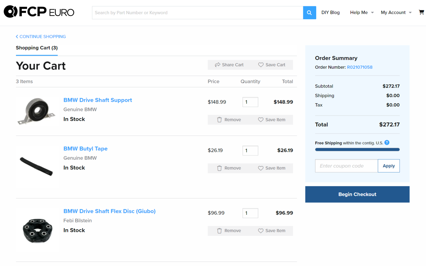

                          On FCP Euro, it's $272 including the butyl tape for the CSB they recommend.
                            Would it be better to get the Meyle flex disc that comes with the bolts and nuts?
