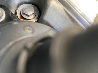

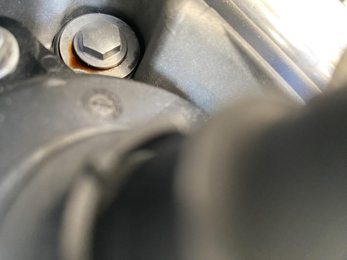

      And actually, I think I can rule out mating surface of the valve cover: The outer/lower part of the grommet, where it contacts the valve cover mating surface is dry. The oil is seeping out in the center where the head of the stud meets the metal washer it sits on, suggesting that the oil is coming up through the center of the grommet, and that even the seal between the bottom of the washer and the top of the grommet is tight. But then why is the seal between the nut head and the top of the washer not tight enough?

        Here's a photo of the seepage so y'all can see what I'm talking about. Everything on the valve cover itself is totally dry.
        Click image for larger version  Name:	IMG_0143.jpg Views:	0 Size:	79.8 KB ID:	284887
          Can you swap that nut and washer to another stud?
            Yeah I guess that's the move for now. I will say that before I refreshed with new hardware this particular position was always the first to start leaking, but it could be a coincidence, or if it's not it'll tell us something weird is going on there. I'll swap it and see how things look after I drive down south for thanksgiving!
              Are you sure there is no debris where the rubber grommet meets the valve cover? Might need to go at it with a pick and a scotchbrite pad.
                Make some pictures with the valve cover removed, maybe we can spot something like your stud being too long.
                  Add another washer. Maybe your cover is warped and the grommet does not seal well
