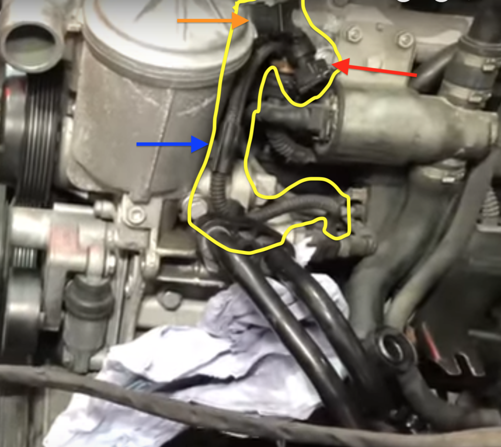

    I'm converting a car to a CSL style plenum using a MAP sensor in the factory air rail and the IAT in the plenum. I think I want to wire these into the loom in the stock locations. Can anyone tell me or provide a pictures as to where these wires enter the loom itself?
    I'm assuming the IAT enters one of the unused "ports" on the wiring housing under the TB actuator?
    What about the MAP sensor does it go into the injector harness where the shut-off valve wiring is?

      Thanks for the reply, the PN# we want for this is 12517833336​, I had googled it and found one harness and it looks like it verified my thoughts on the MAP sensor, but its not 100% clear. The IAT is not distinguishable in its routing as well. Just wanted some confirmation before I just made it happen, ha.

          Completely forgot about the Redish video - skip to 1:46:00
Name:	Screen Shot 2024-07-03 at 3.49.05 PM.png

            Thanks for those leads, I still don't see 100% but I think its enough to know the direction I'll take with it.

              I'm fairly sure the cable marked in yellow is the AIT plug and the flap motor plug (red and orange arrows). The blue arrow is a plastic Y splitter that splits the two connecters. It all routes near the oil pressure switch. I want to say it routes through from the cable box under the ICV.

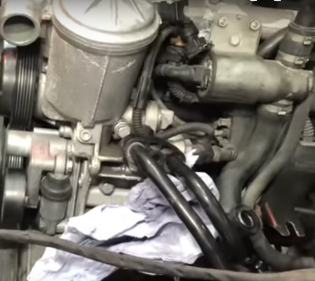

              Click image for larger version  Name:	Screen Shot 2024-07-03 at 3.49.05 PM.png Views:	0 Size:	902.0 KB ID:	270740
              Click image for larger version  Name:	Screen Shot 2024-07-04 at 9.22.02 AM.png Views:	0 Size:	866.2 KB ID:	270741
