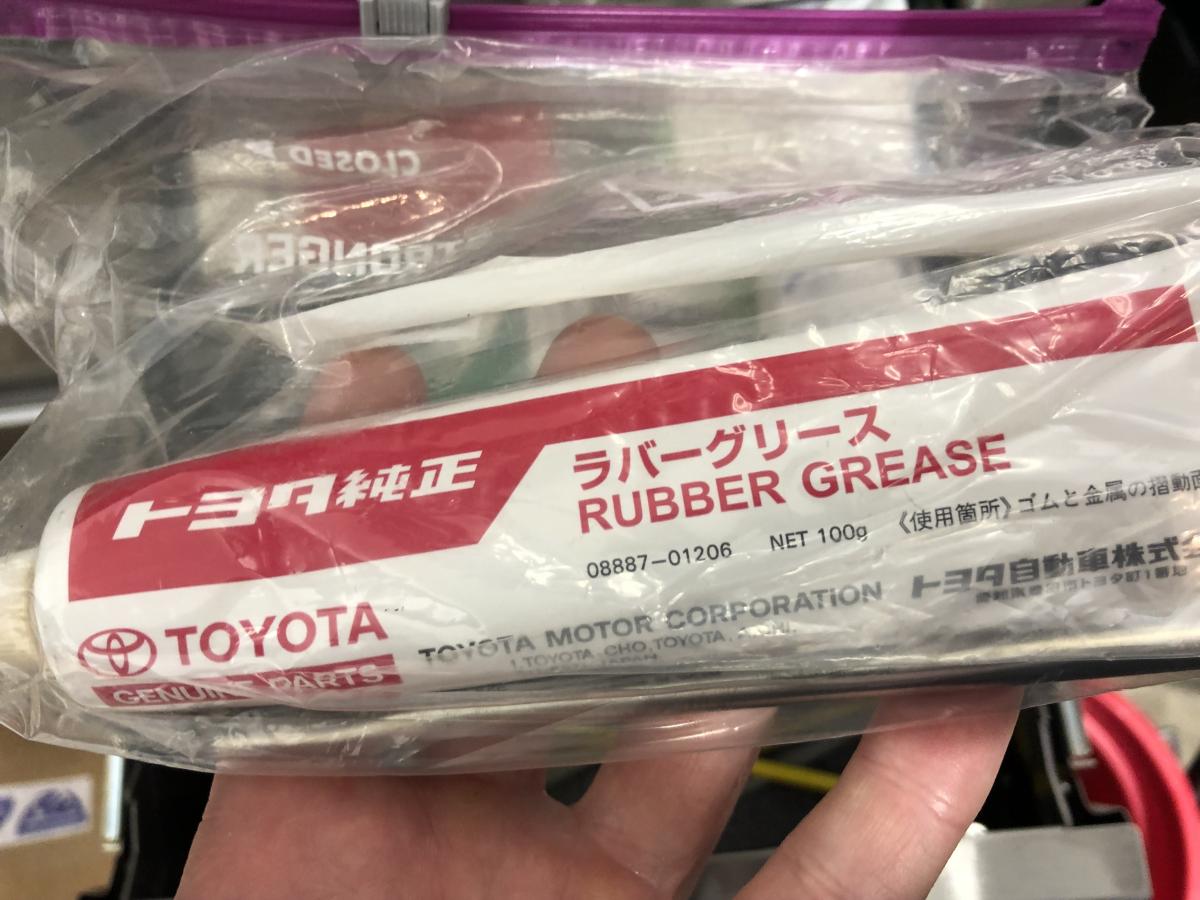

        No Plastilube on the pins inside rubber bushings. I use Toyota lithium soap grease, no problems.
