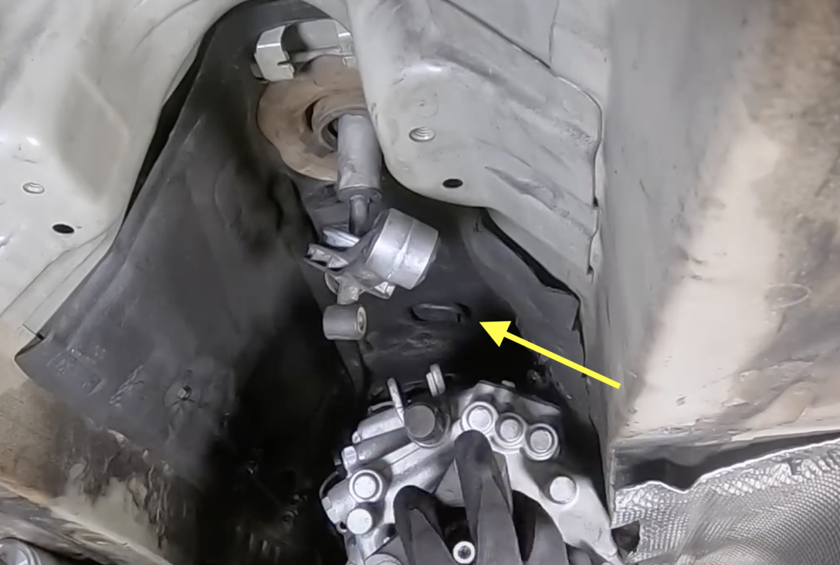

      Thanks for the confirmation bigjae46, stuck my whole arm up there and didn't feel anything so it must really be in the absolute worst spot.

          Thanks Slideways this was super helpful.
          For anyone else looking to do this, I ended up removing section 1 and the transmission mount, while leaving the driveshaft attached. The couple inches of clearance was just barely enough for me to blindly snake the aerosol tube of evap cleaner up the drain, although if you have beefy hands it might not be possible without lowering the transmission further.
          They really couldn't have put this thing in a harder spot to reach. On other BMW models the drain is offset to either side of the transmission and visible without disassembly, while other makes run the tube down to the level of the undercarriage.

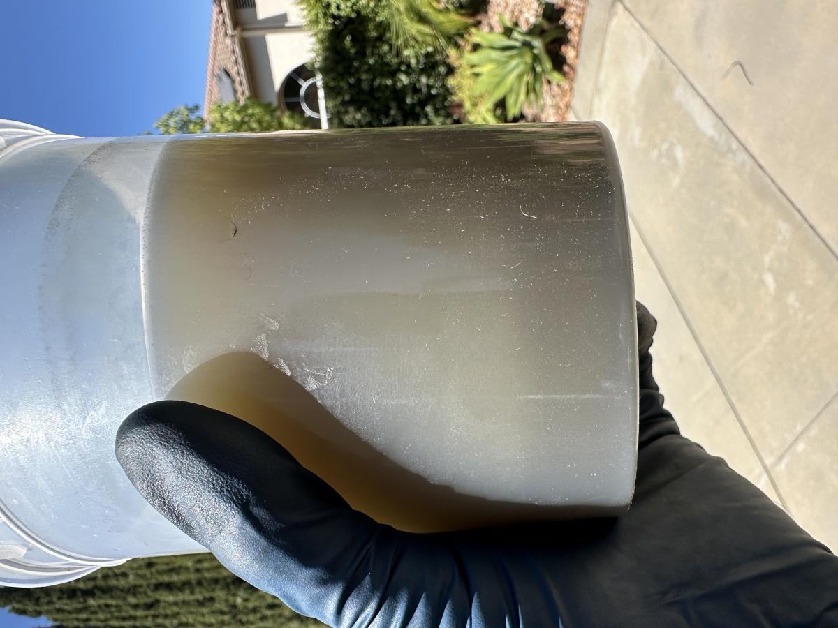

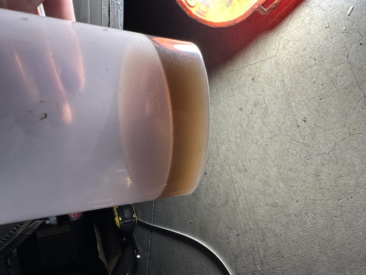

          At this point I'm in the habit of assuming that the PO never performed anything other than oil changes, so this is what 20 years and 190k miles of buildup looks like after 2 foam treatments.
          Click image for larger version  Name:	Image_20240720_121846_669.jpg Views:	0 Size:	144.7 KB ID:	272592
          Click image for larger version  Name:	Image_20240720_121846_771.jpg Views:	0 Size:	112.8 KB ID:	272593​
