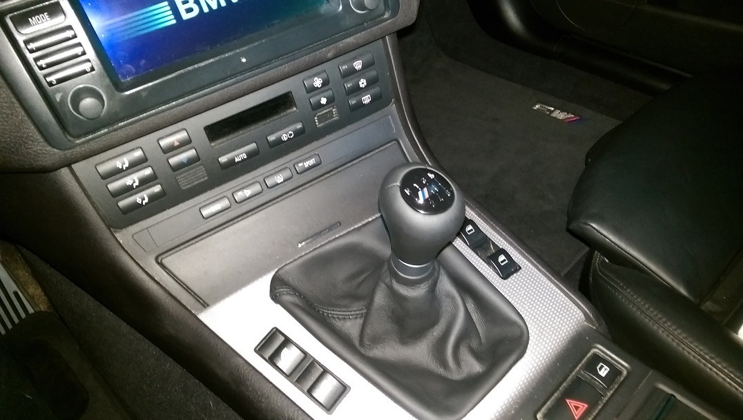

      My recommendation would be the OE E46 M3 boot (find a used one with a worn out knob and cut it off) and the weighted gooseneck M 6-speed knob (P/N 25117896884). Weighted knob has a much better feel compared to the non-weighted OE unit, especially if you have an SSK.
      Non-M3 E46 boots (genuine BMW) are made vinyl or Montana leather and they only have one or two stitched lines vs. the M3 version which is Nappa leather and has stitching in all 4 corners - looks much nicer IMO. When you cut the knob off of the M3 boot, you simply have to fold the top and tie it with a zip tie from the inside before installing the boot into the shifter trim and then install the knob. It will look original other than the boot and knob not being one piece. Here's how it looked in my M3: https://photos.app.goo.gl/msy5ZqyyvEzUYaU57

        You can take the plastic bezel off the original shift boot and transfer it to the F10 knob/boot combo. That way, you keep the F10 shift knob as one piece with its genuine leather shift boot. You will have to position the stitching so it is even on both sides since it won't line up perfectly with the two top corners.
        IIRC I've done this before and wasn't a fan, it was ok, but considering the time investment and cost of an F10 setup I'd probably just bite the bullet and go M3.
        As you mentioned, there are one or two really nice nappa leather boot options on eBay, but they add cost vs the two options above.
        Ya, I agree buying an F10 setup and then a Nappa boot, probably ought to just buy the M3 unless the height is something that matters.
        Second option is to use the leather boot from a stock E46 M3 shift knob.

        I hadn't even thought about the idea of folding the cut leather inside like a normal boot. That is a good idea to keep the Nappa boot with a different knob. The present shifter is to nice to chop up though.
