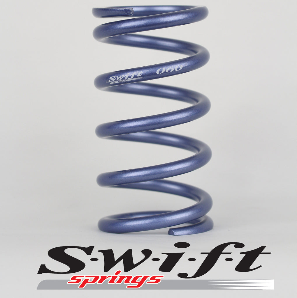

        Do your eibach coilovers have linear or progressive springs ? Progressives will give you slightly better ride but will compromise on handling.
        I can’t speak for other springs but I recently put on swift linear springs on my KW coilovers and I love how they feel. Firm yet smooth. That being said if you hit a pothole or really bad road you will definitely feel it. They are linear springs.
        Which sizes and rates did you go with? I’m toying with the idea of trying linear springs on my Clubsport dampers maybe sometime in the next year.
                          I ended up going with the following based on recommendations from swift. 559 lbs is a bit on the higher side for a street car but my ride is still pretty smooth yet firm. It does hit hard though when you do end up hitting a bad pothole but overall I am very happy with switching over. long story short, I had to switch to these springs to install my ground control camber plates.
