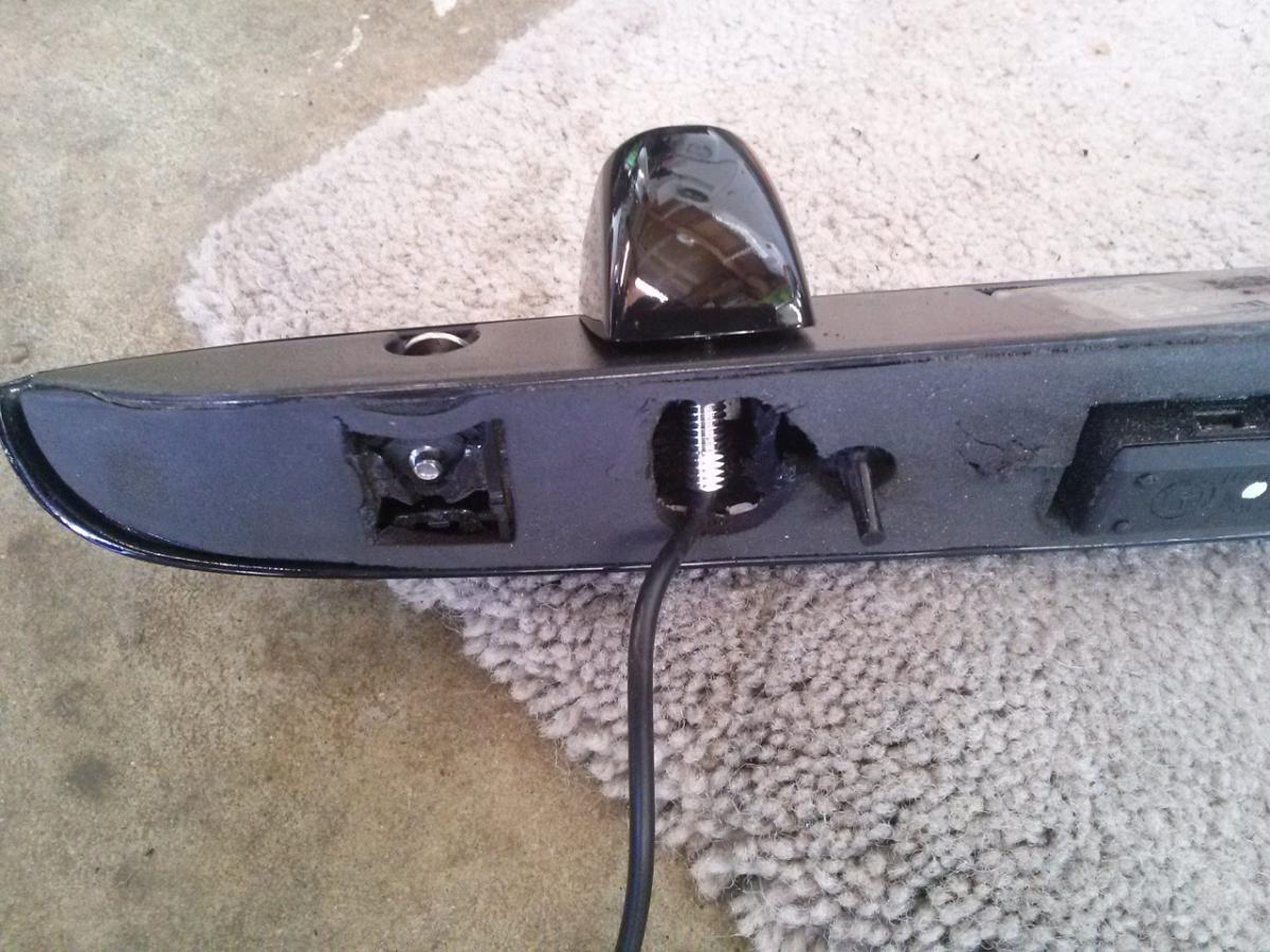

            Personally I just drilled a small hole and mounted the camera a bit off to the side. Not a fan of the license plate light cameras, and I had this camera on hand for 5 years, as it came with my car.
            To be honest it is hideous, literally a black pimple on the back of my car. I do have to take the trunk handle off again to install a missing trunk handle gasket, so I'm going to colour match the camera housing with some touch-up paint

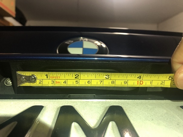

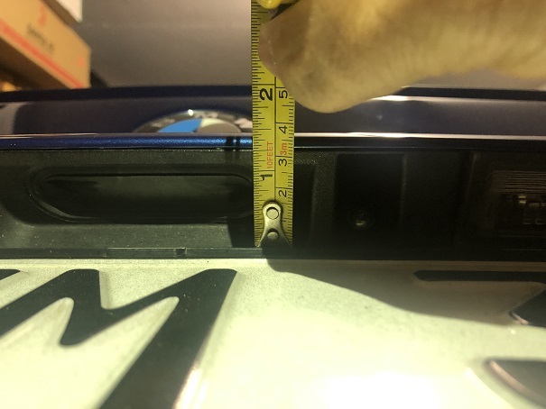

              If you have the LCI trunk handle, there is nothing to pop out. There is no separate trunk button part -- the rubber portion of the button is "stuck" on the main piece of the bottom/black part of the trunk handle. To use those eBay trunk handle cameras, you have to saw/dremel a hole into that piece. Secondly, most trunk handle cameras I've seen are too long (e.g., 11cm or more) and too wide (e.g., 4cm or more), not even considering the portion of those cameras that will have to live inside the trunk handle itself. The recessed area for the button in between the recessed areas where the screws go is only 10cm long and 3cm wide. You have to cut into the portion between the two recesses to fit the 11cm ones.

              The camera-only solution is a better option (until an E46-specific trunk handle option comes out) but I agree a bit that those ones look like a "black pimple" ... not sure if it would look better if the camera is painted body color.

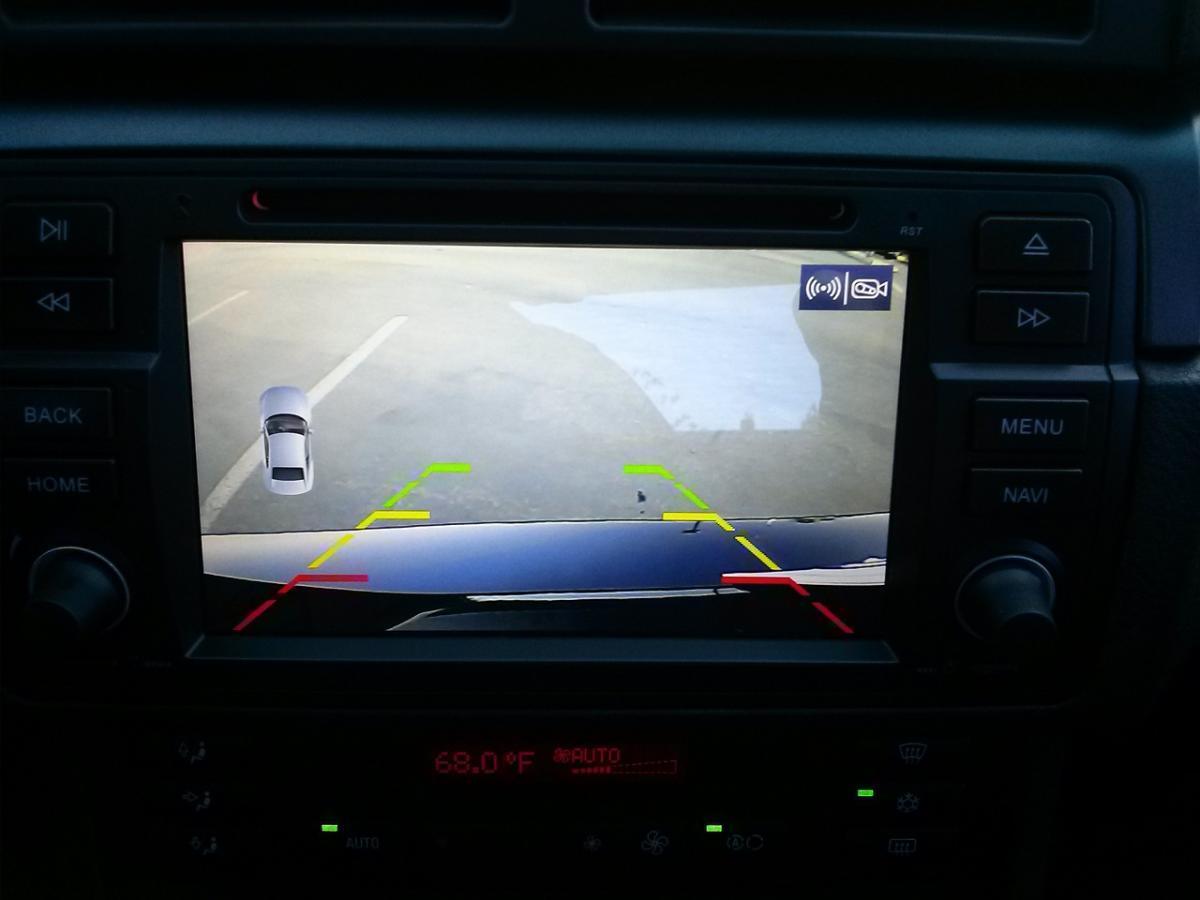

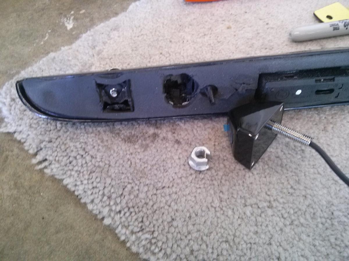

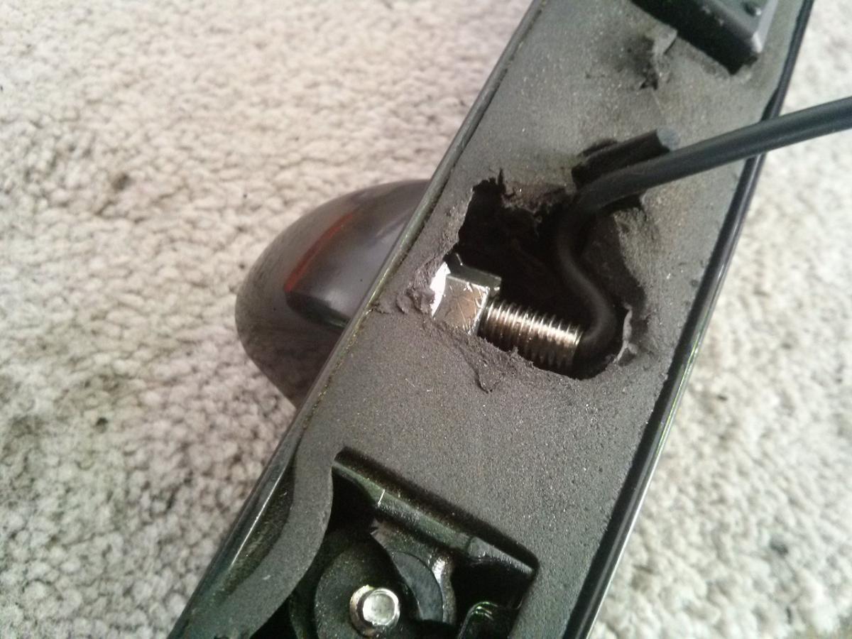

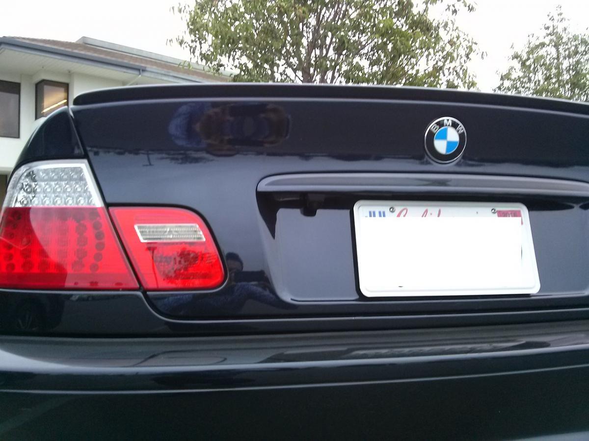

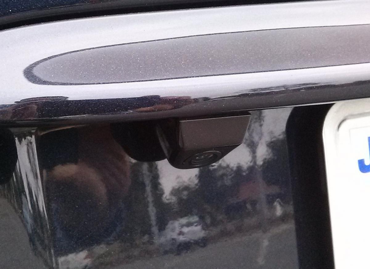

ID:	27775 Here's how I did mine. Used a stand alone unit. The trunk handle cameras are not made for the E46 despite being advertised as such, same with the license plate light ones. Fitment is horrible.
                  Here's how I did mine. Used a stand alone unit. The trunk handle cameras are not made for the E46 despite being advertised as such, same with the license plate light ones. Fitment is horrible. Click image for larger version

                    That's annoying! Will try to return that piece. That DIY job of yours turned out really well! I'm just wary of drilling into the trunk's facia like that, don't want to make any permanent changes.
